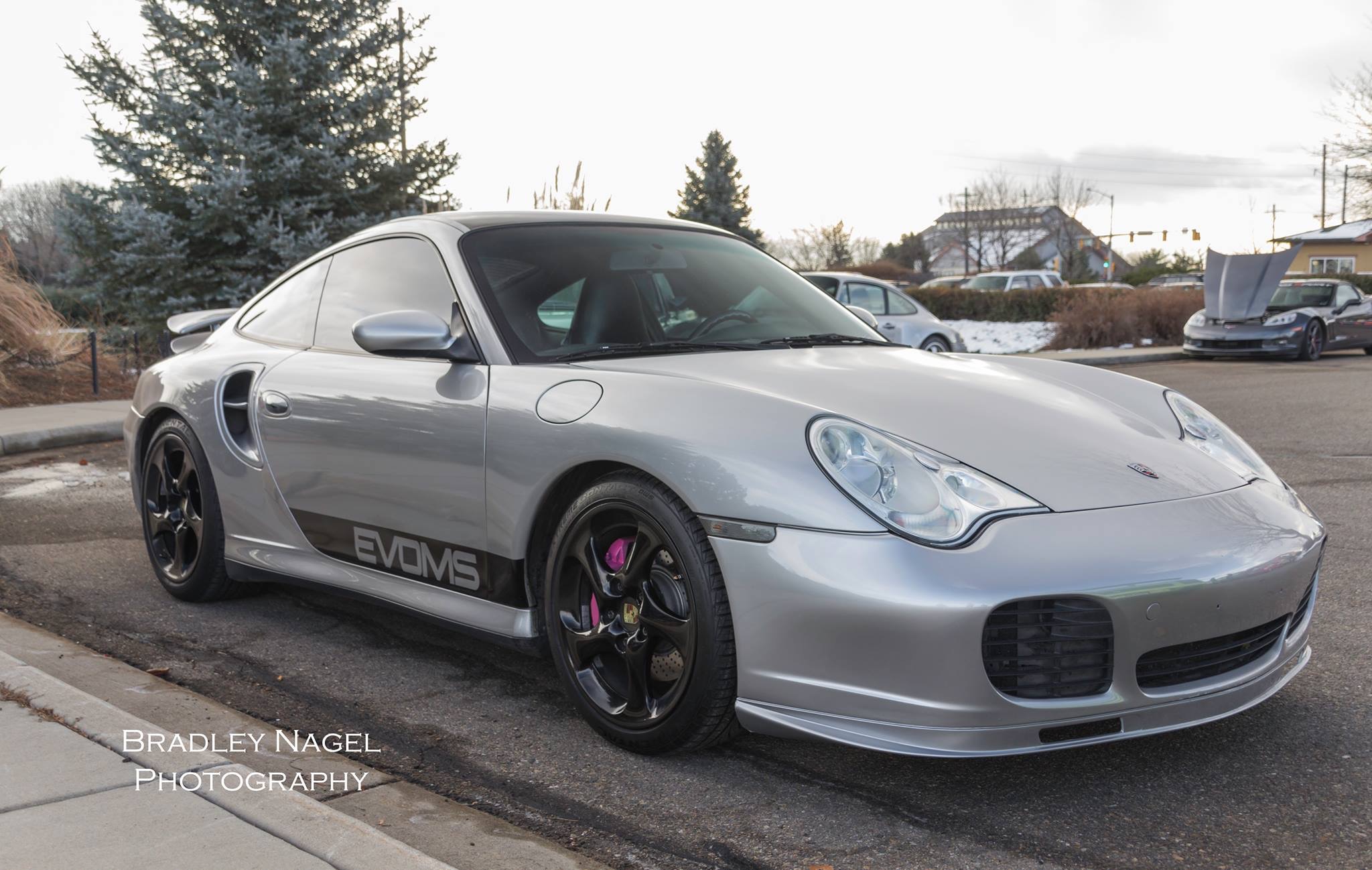

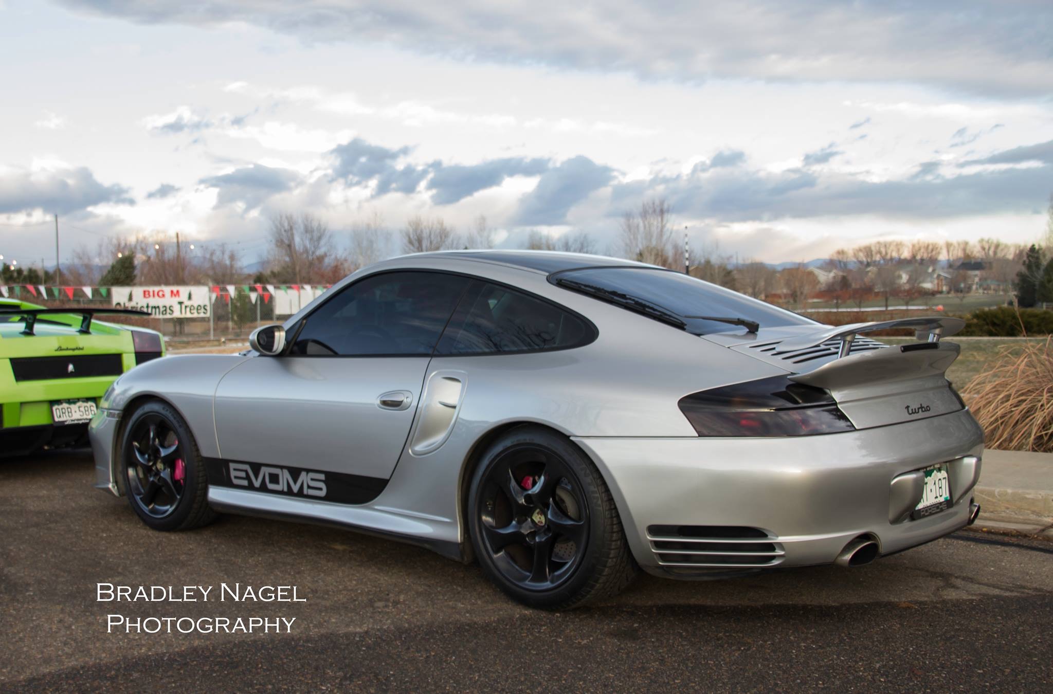

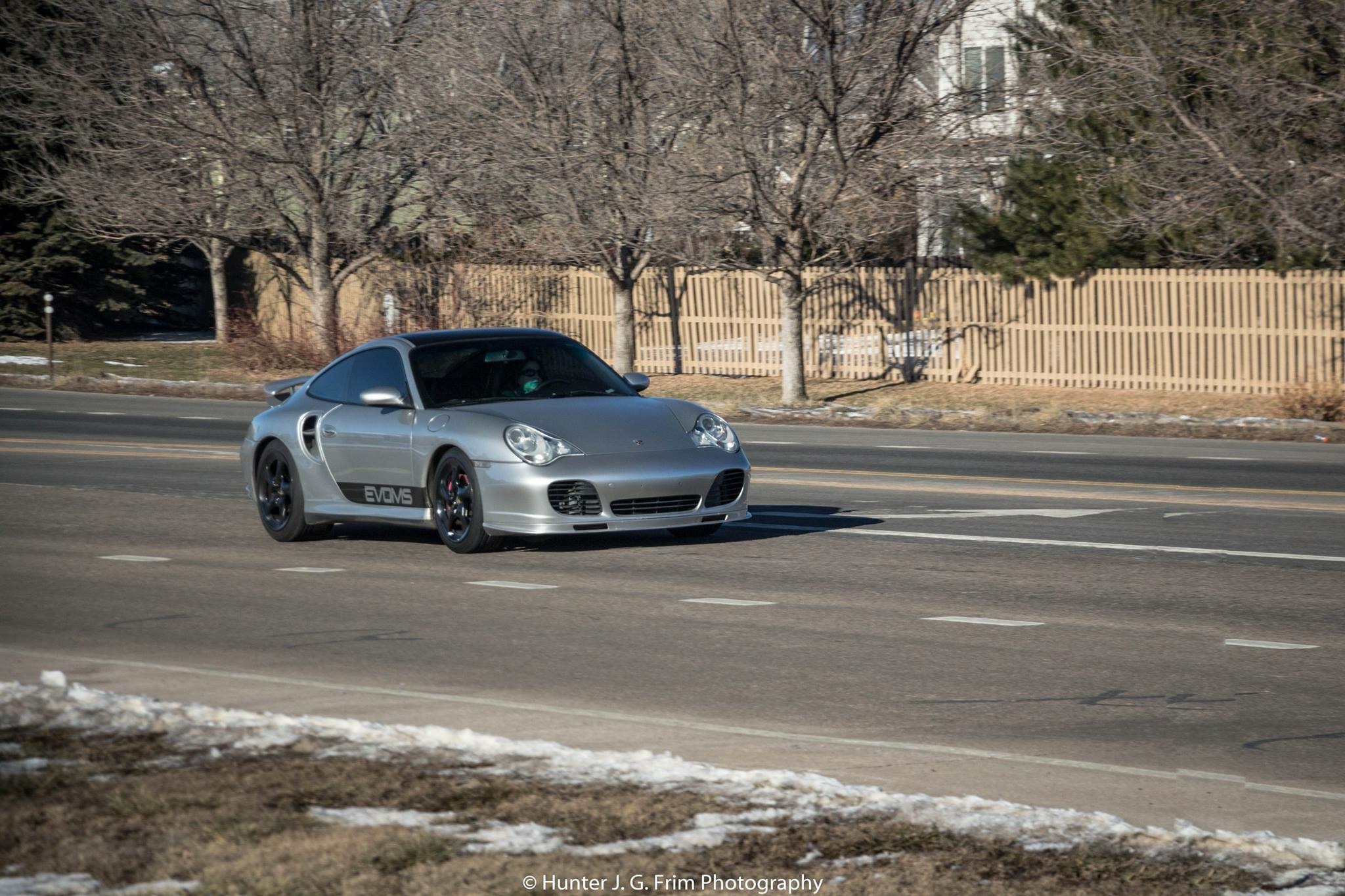

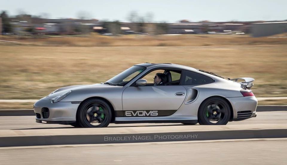

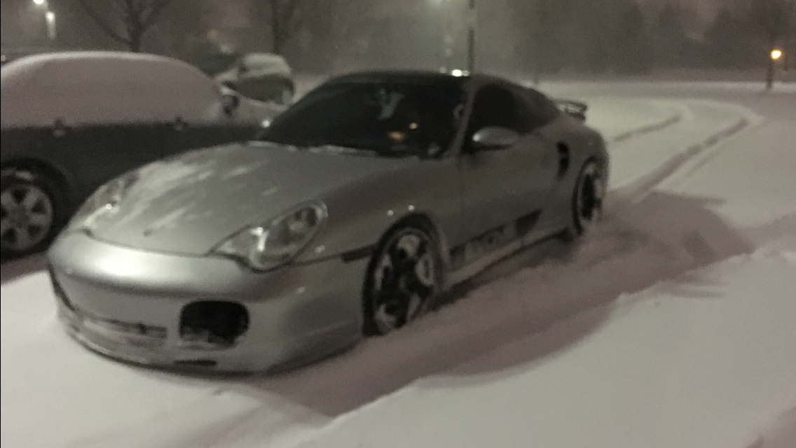

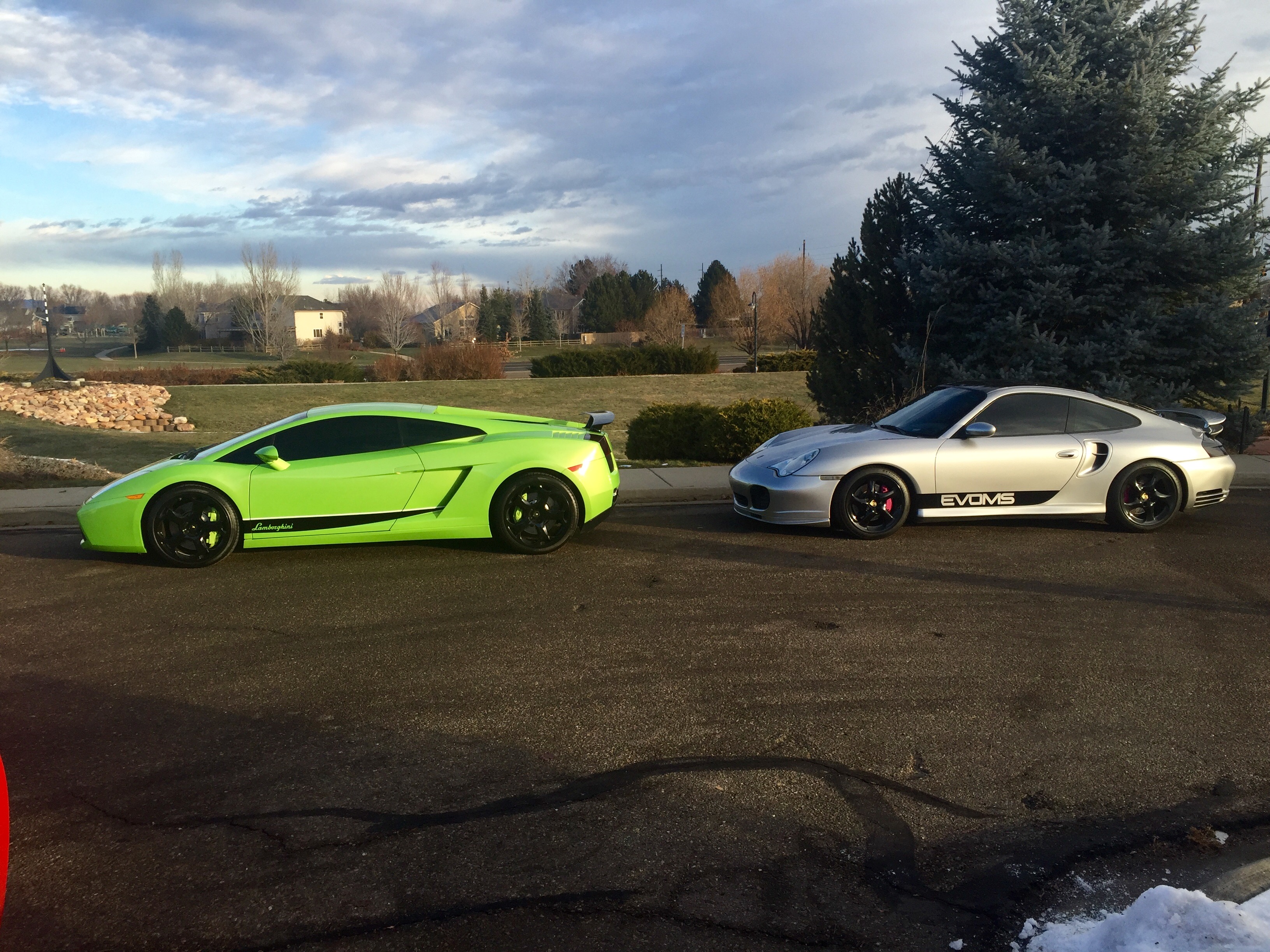

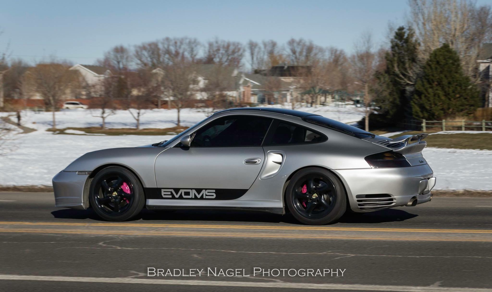

My 01 996TT tiptronic currently has evoms diverter valves, evoms tune and custom 2.5" x pipe exhaust (straight pipes). I am looking for the next best bang for the buck mods and what I can anticipate to spend and hp gain?
I'm thinking evoms intake and a version of upgraded turbos but I don't want to spend an arm and leg since I have other cars to spend money on as well and my girlfriend daily drives this car anyways - so I hardly get to drive it lol
Let me know your thoughts on which direction to go!

I would suggest more pictures of things that don't matter
