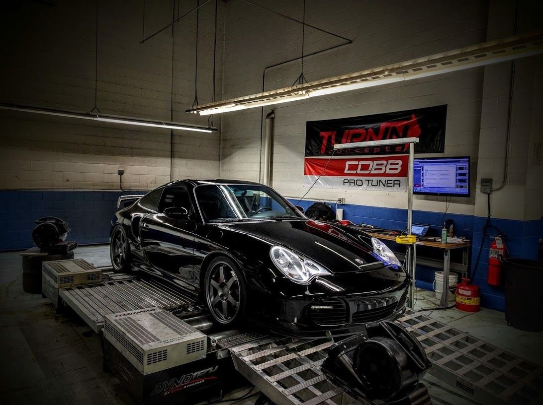

The car put down 743AWHP and 700AWTQ on a dyno dynamics dyno on e85. Likewise, it put down 600/600 on pump gas and less boost.
Corbin Johnson (from Johnson Tuning) believes there's a bit more in her if we give her more fuel (ahem...Sean West.....) but I'm happy with the 700 number for now. I'm not sure what is around here that would take it, though I know it doesn't measure up to our friends down in Texas. Maybe next year we'll talk about cranking her up a little more after doing bigger injectors and fuel pump. The car is still AWD and probably nearing the limit of the front diff and trans, hence my fear of cranking it up even more.
