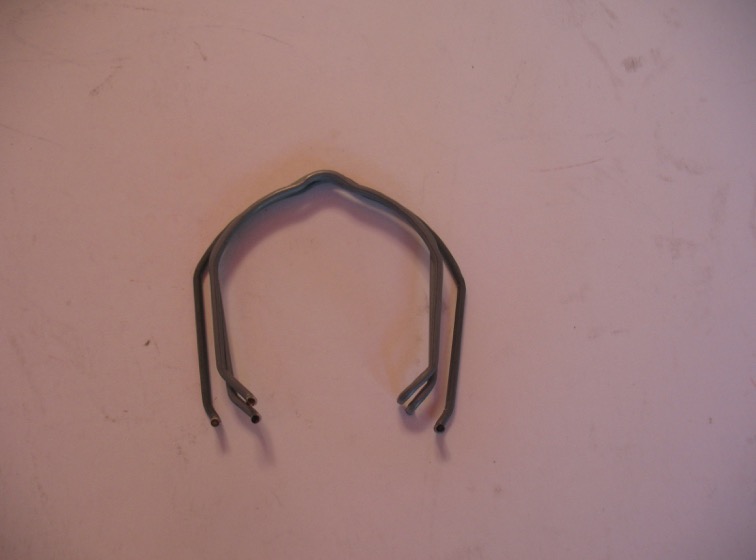

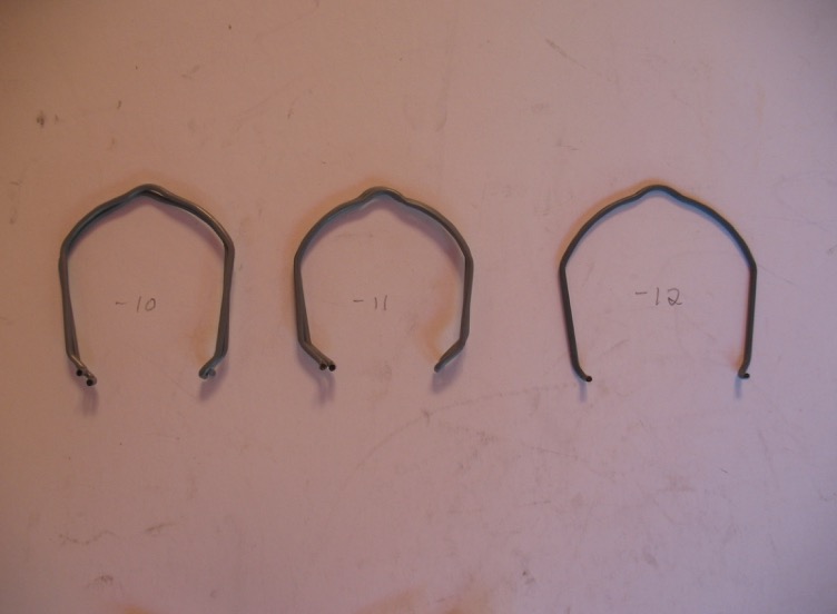

It is really important to have the proper clip in the proper position. You can found more than 7 different size of those clips on the TT. (99610680211 99610680210 99610680212 99610680215 99610680216 99610680217 99951231700) Some of them are really just a bit bigger or smaller and if you put them in the wrong place it will pop out... If you look at the picture you will see they are similar but different part#!!!!
