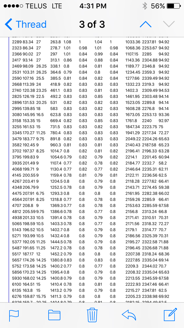

Here's my 1.2 bar tune by Markski, kept tame down low due to GT28 turbos. Stock injectors running 90% duty.
Rpm load ignition angle MAF Lambda 1 lambda 2 boost sensor boost setpoint n75 duty

Great log. You had a little pulled timing at 4400 to 4600rpm.
90% is not good one hiccup and it could be your last. When i found out i was running 108% duty cycle i put big injectors in after that.

I know it's pushing the pump and the injectors capacity, that's why I also have a 0.8 bar tune that I'm currently using until I get bigger injectors. I think a 1bar tune would be perfect for me in terms of reliability and drivability.

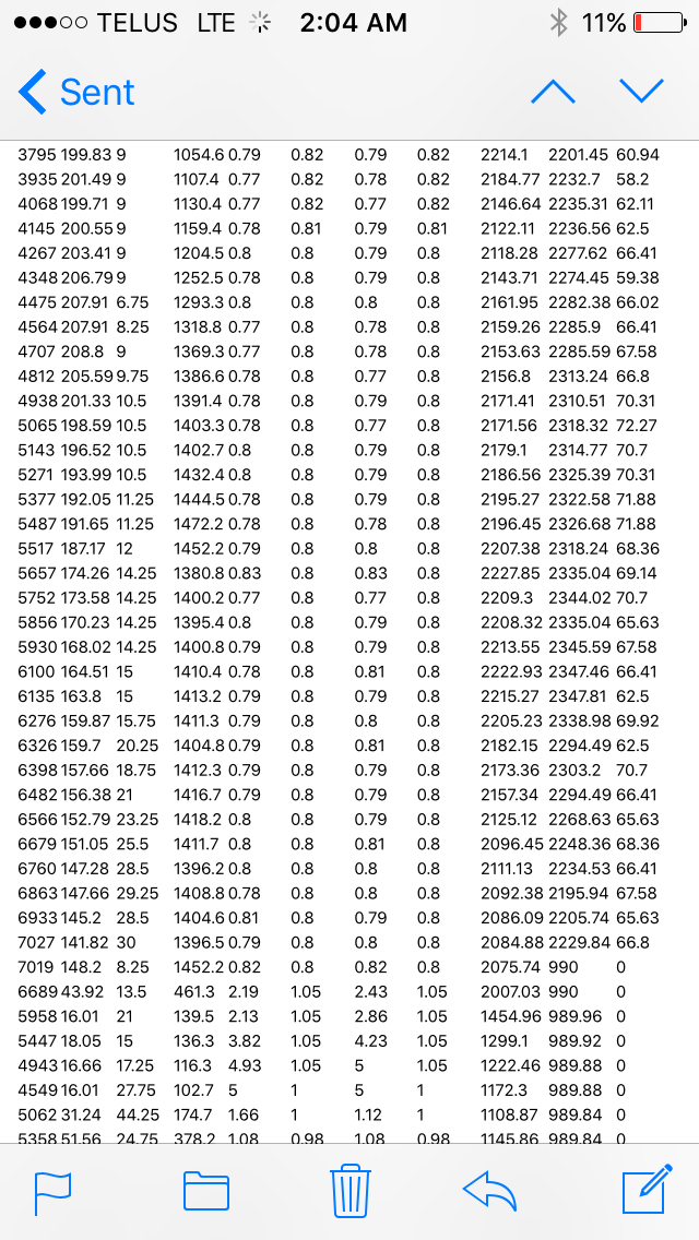

I was reading your conversation about timing on another thread and went back and looked at my log and noticed I had cropped out the very end of my log at 7000 rpm. Lots of advanced timing at that point. Is it to compensate for how fast the pistons are moving?

You can see from 6300rpm and on your timing is going crazy lol. Look at your boost it starts to drop alot too when timing is being advanced so much. It means its pulling timing.
It looks great before 6300rpm then timing goes way up not sure why. Im not an expert but i do so many logs i get used to it.

Have you logged as high as 7000 rpm and your timing stays below 16 on 93 oct?

Lots of things are starting to drop off at that point too, engine load, air flow, boost. Maybe the timing is advancing to try and keep the power up.
