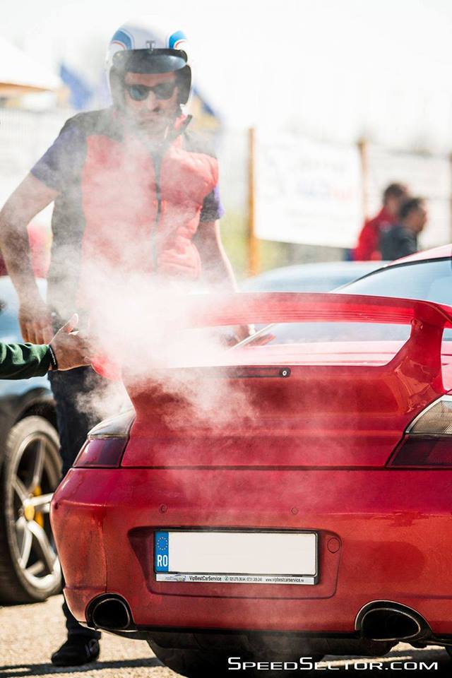

One quick Q.. at the last track event I had a massive coolant leak, had vapors of coolant everywhere and even the guys following me were loosing traction because of my coolant all over. The coolant seemed to go somehow to the drivers rear wheel, my coolant pipes are welded and if driving normally the car it looses the level pretty fast now but we are unable to locate where the leak is located or what is the problem.
Were thinking to replace some common hoses, the coolant tank, the coolant valve from the tank, etc... Anybody had this problem ? drives me crazy... missed a very nice event at the track, travelled 500miles each way to race 35-40 supercars and wasnt able to complete even one clean lap. Seems the coolant gets hot, pressure is climbing through the roof and its getting out somehow..
On another note, is there any racing thermostat available for our cars, something to trigger way sooner the fans and keep everything happy ?

Hi Fadi,
don't just change parts when you don't know which one is broken. Do a pressure test on the coolant system, just like you would on the air system. Check your water pump housing and the heat exchanger on top of the engine, behind the throttle plate .
When filling the car with coolant, you use a vacuum system. This is also good for checking for leaks.
Different thermostats won't do anything for you, except extending the time it needs to get you car to operating temperature. Do you have a problem with temps?

Hi Andreas, no problem with temps as long as the coolant level is normal. When starting to loose coolant obvisously the temps are raising, had once only at 120C but normally when loosing 2-3L of coolant the temps are normal or in the 90s C
I will follow your advice, didnt pressure test the system yet

Once the coolant pipes expand from pressure thats when you have a leak. I found my leak when pressure testing from both radiators.

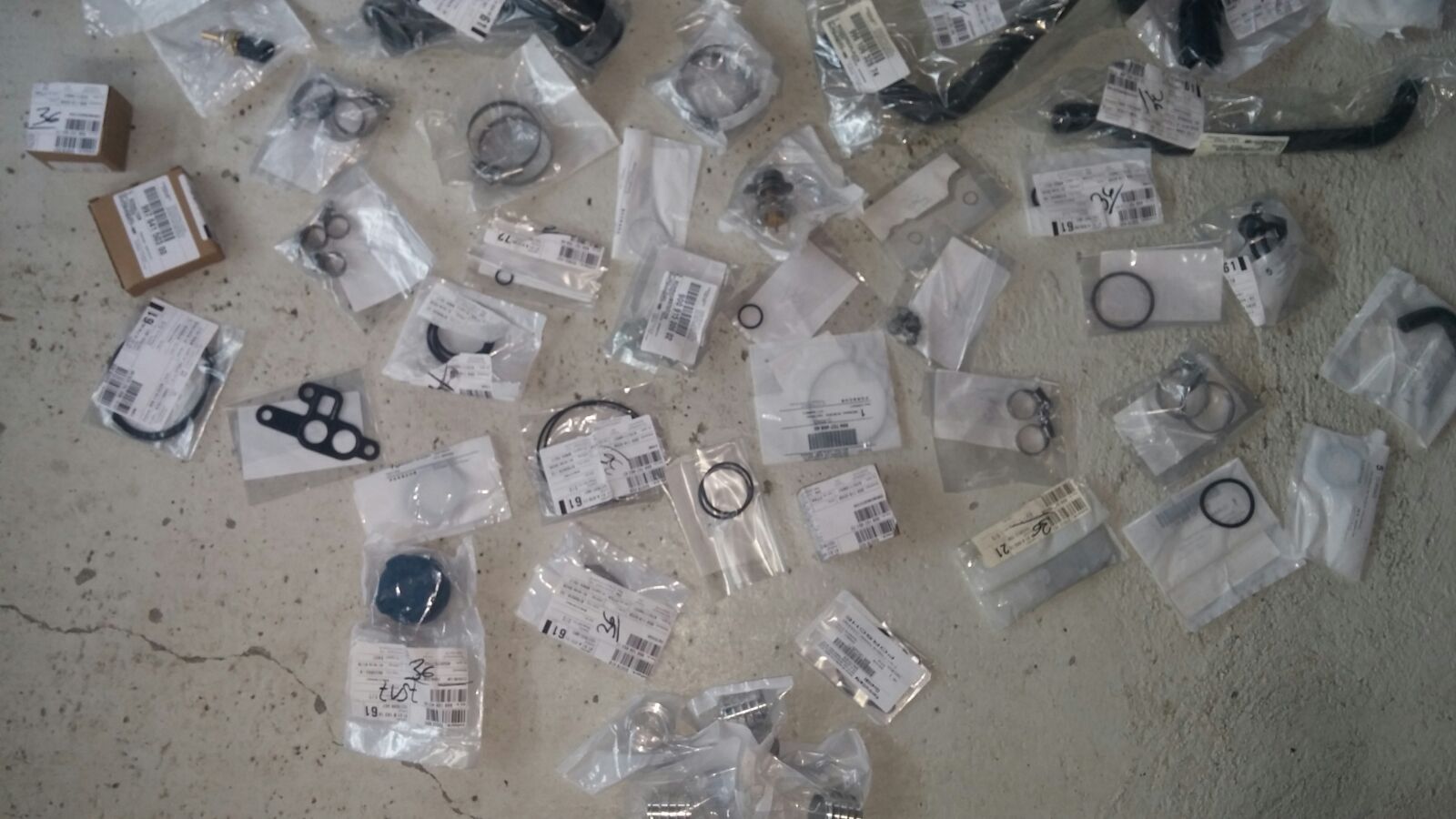

I have bought almost all parts form the engine bay related to coolant system, new hoses, sealsm new water tank, etc... Got to the track without testing before as car was ready the night before the track event.
Was able to run 4 laps, when got back I have seen some steam and was AGAIN from the cooland system, engine bay was wet all over but nothing like before.. and no coolant low level, temps on the engine were ok.
After a short break of maybe 30min got back at the track and right after the warm up lap, the hose from the front right radiator was out and wooowwwwwww I was blind at 130mph on the straight line just before the turn... dangerous.... continued the lap with a lot of coolant steam in the back of my car, got to the pits, water was like 100C..
Bought some distilled water, put back the hose and just started the engine at idle... after 2 mins the water was 100C... this was the FIRST TIME I have seen this happening at idle, temps were warm but not hot, maybe 23C or so
Now... I remember this happened for the first time December 2014 when I did 2.2bar on my car, both my oem radiators cracked that night !!! Replaced them with some cheap radiators and at the same track from the yesterday event, at the same spot one of the radiators blew up, thats at the end of a long straight line of 1/2mile (maybe 600m or 1/3mile is the exact spot) when I am keeping the acceleration for a long time
I guess the problem is elsewhere and I am fixing the effect and not the cause... the problem might be the huge pressure in the coolant system.
Now as I did 2.2bar (first time problems) and the high pressure might mean a headgasket problem, what do you think ? I will check the headgasket anyway, but interested if anybody else had this problem and what the fix was, it is driving me crazy already

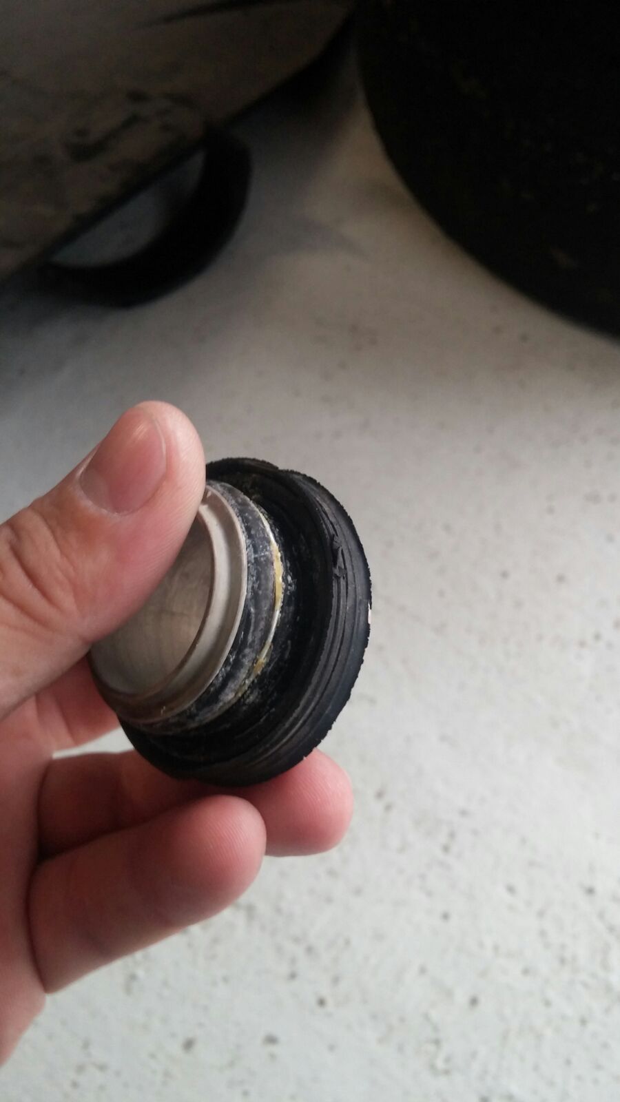

coolant
Before this track event I have replaced all parts from the pics, found some damaged parts and the pic with the rear of the car is made before changing all these parts
