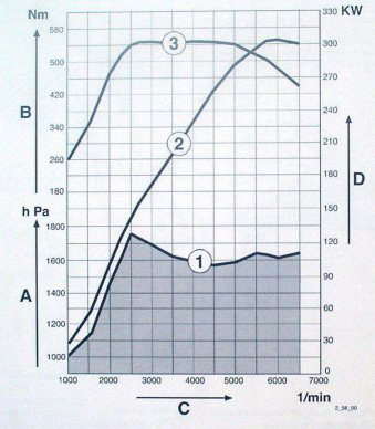

To answer your question about the ECU limiting boost in lower rpms... Not really. Boost is limited via the load placed on the car and the size of the turbos. The ECU tries to do the same in all gears, actually. 1st-3rd gears (1st and 2nd especially) run out before the turbos have a chance to really stay at a certain RPM and get a measurement. I am sure that there is some lag on the digital reading as well when this happens. What do you pull in 5th/6th?
The problem is that the ECU on the stock TT (with K16s, no clue how the X50 curve looks, but I would assume that it is similar) peaks to ~0.8bar, drops to 0.6 bar, then peaks again at 6000rpm to ~0.7 bar. Getting 1.0 must be a product of the hybrid turbos. As you can see, the boost is ECU controlled.
The stock boost curve (1) is below (remember that it is taken at 1 atm I do believe, so you have to subtract that out in order to get the absolute pressure):
