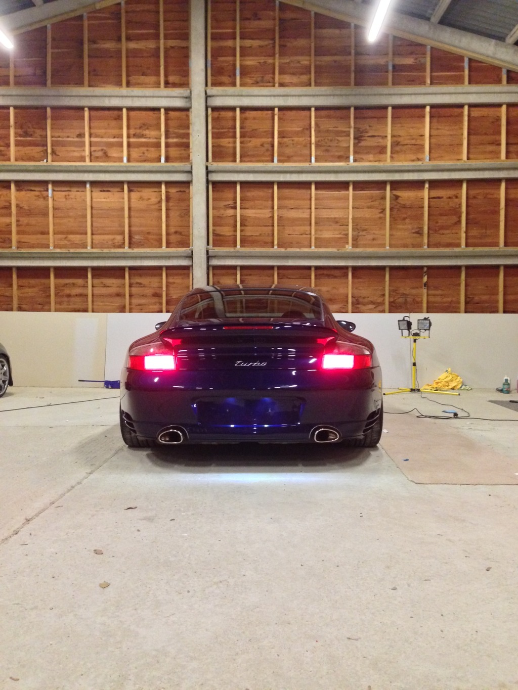

Im running 15mm spacers all round along with GT2 ride height and cambers on standard hollow spoke wheels.
Damper settings are both 5 front and rear.
I feel the steering to be almost too direct. I feel every bump in the road (UK roads) however at higher speeds I really have to hold tightly onto the wheel as there is almost too much feedback through the steering wheel.
Can anyone advise?
Perhaps the camber setting is too harsh? However I love the stance and "poke" of the cambers.
Front and rear control arms have been replaced in the past too....
Thanks

I had the same issue with my FVD PSS9s. I fear that you might be beyond the functionality of the coilovers at GT2 ride heights. I raised mine up a bit and the car felt much better on the highway. I would also advise to running the settings staggered with a stiffer setting in the rear due to all of the weight. This is what I have seen others recommend and how I have it on my car.

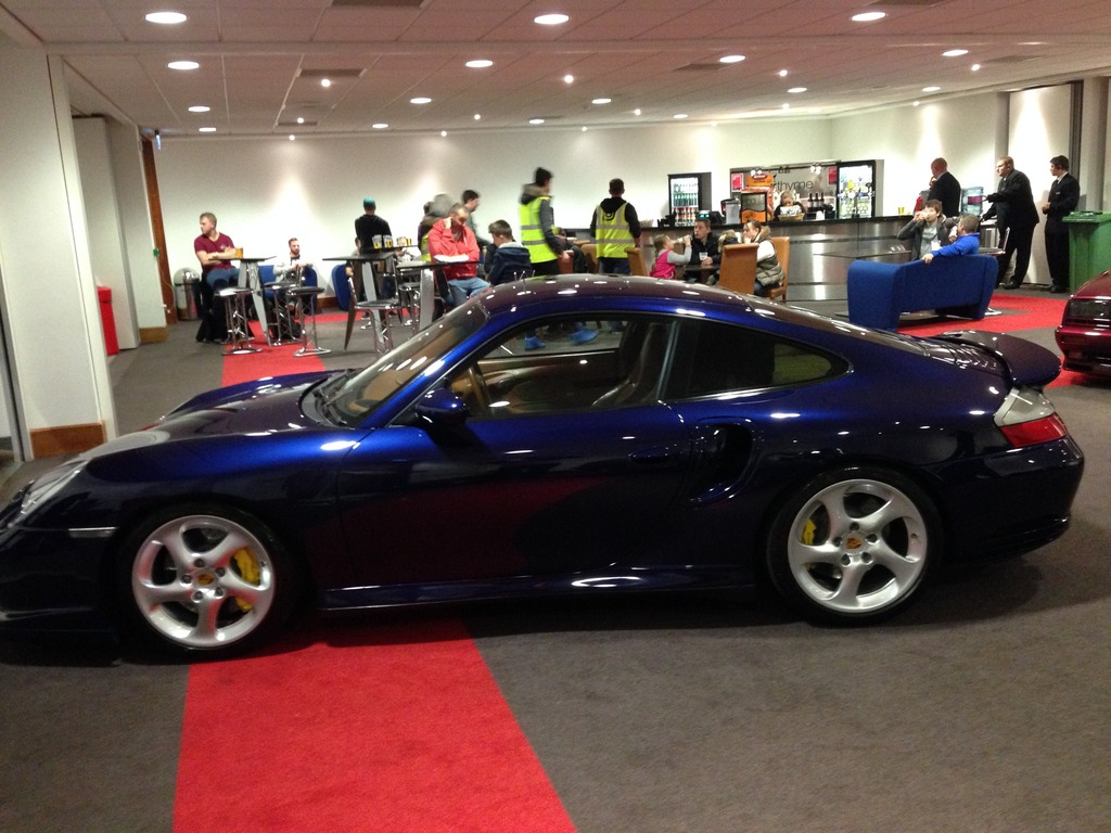

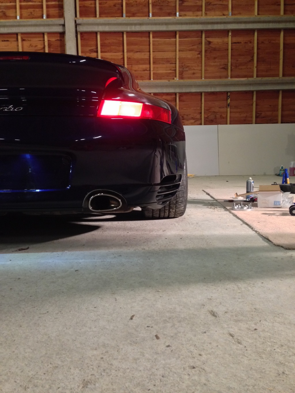

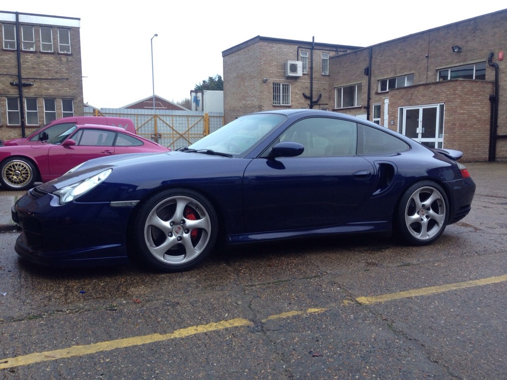

Here are some pics of the setup, hopefully someone else can chime in to confirm.

I think most reviews state that they arent that good outside of their recommended height adjustments. I just had to raise mine a little bit and it feels so much better. But, yes, if you want GT2 height, dont go for these.

+1 on the ride height. Go up 10mm, align and try setting 4-6 to see what feels right.

I suggest setting the ride height to within the bilstein recommended range, see page 7 of this document: PSS10 Installation
The front's only have a 10mm recommended adjustment range and the rears only have a 5mm recommended adjustment range.
