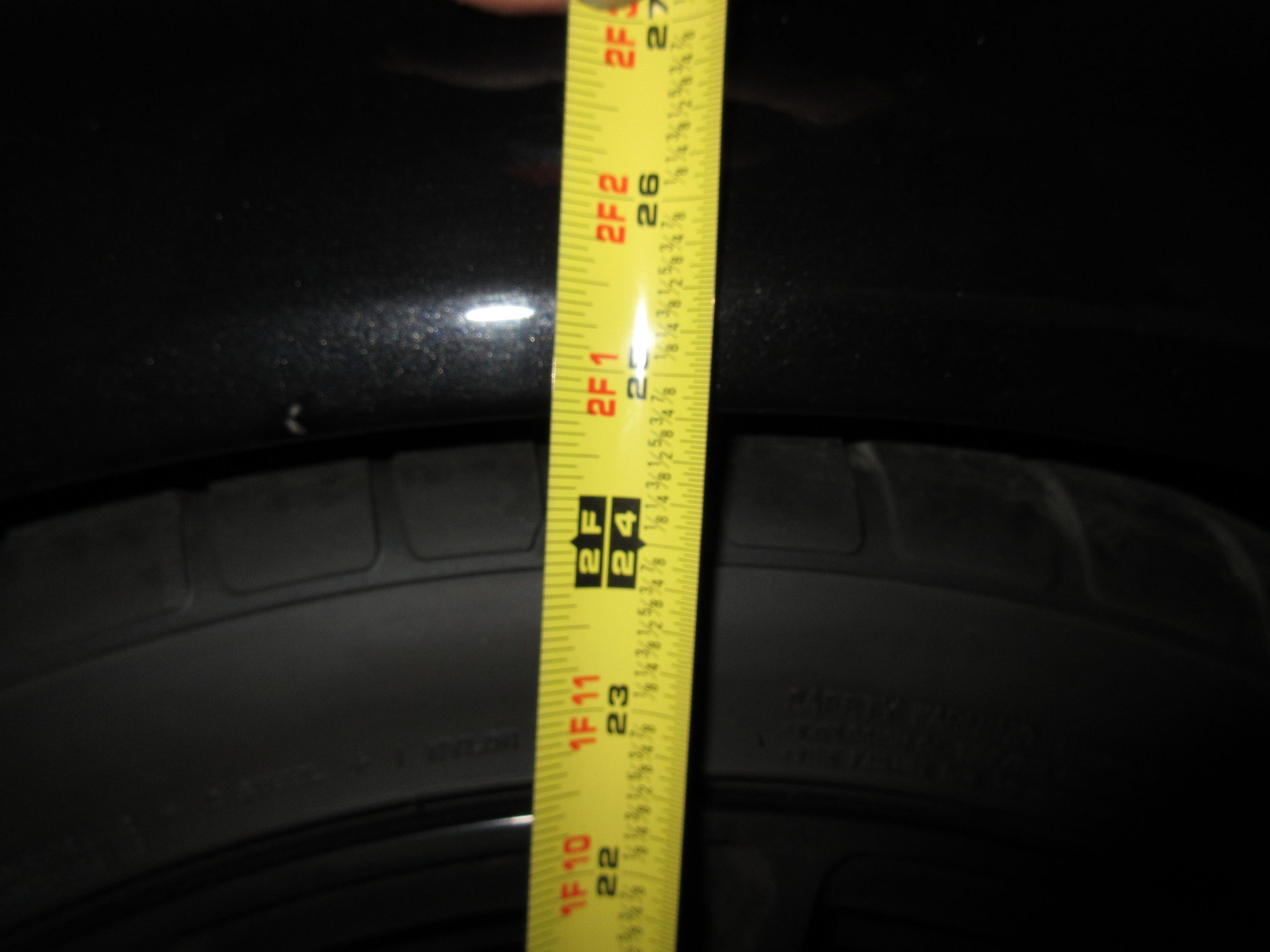

Yes, I know I'm low. Lower than both ROW GT2 and ROW GT3. Here's a pic I just took in the garage of the front at 24 3/4" fender opening to ground, rear looks to be 25 1/4". I'm on Sumitomo HTRZ 2, 245/40ZR18 front and 285/35ZR18 rear. Fronts are 25.8" diameter at 806 revs, rears 25.9 at 809 revs/mile. I still have more work to do. I will keep fiddling with my ride height until my handling gets worse, then go back to where it felt best. If it's not too low, I'll get a pro alignment.
You are riding on the internal bumps tops at that height with PSS10s. I'd set it at the Bilstein specified height.

I'm within the manufacturers recommended range of adjustment and I'm using KW V1 coilovers not PSS9,10. My tires now are about 1" taller than my previous ones and with them I experimented and did get it to the point of bottoming on the bump stops. It rode like a ridged frame chopper, lol. I believe I have my full range of motion now, I'll check and if not adjust from there.
