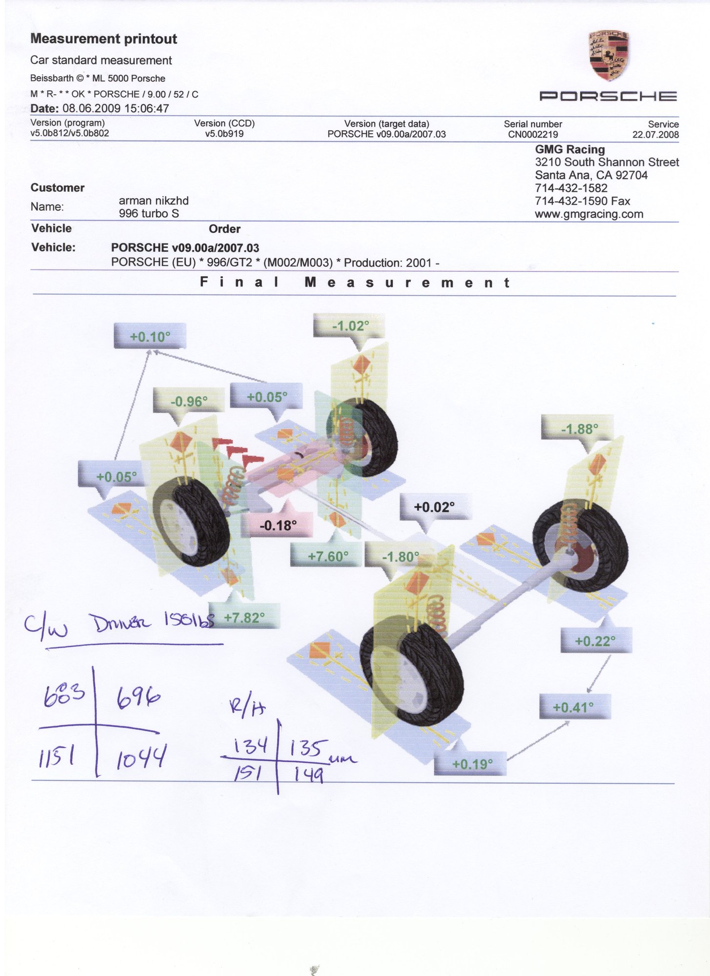

I had the same issue with Moton's in my car, GMG aligned the car yet it continued to pull right. Then, I tool it back for a full corner balancing using their individual scales and boom all good.
Since then BBi has taken care of my suspension setup and they do the same practically, but not using digital readers or lasers (old school). I am enclosing my setup from GMG, hoping this will help you as well.

Arman, thank you for those specs. I didn't ask them if they corner balanced the car because, to be honest, I didn't even know what that was until now when I just looked it up, lol. Makes sense though how that could have an effect on alignment.

Corner balancing must be done prior to alignment as any change in ride height/balance will affect alignment...knowing your pull issue I'm surprised your dealer (well maybe not surprised) didn't corner balance first...should be done with you or something your weight in the drivers seat
They just said corner balancing is something they do by request. I wish I new how important that was so I could have asked for it. Seems like it should be part of a regular alignment on a high performance car like 911 Turbo, especially if they're having difficulty with the alignment.
Anyways, they figured out how to adjust the coilover heights, and say the tech is really happy with the alignment now. I just hope that by adjusting the height they didn't throw off the corner balance.
