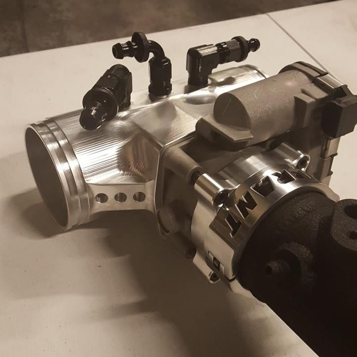

Originally Posted by 32krazy!
i have seen at least 3 ipd plenums with leaks at the top of the plenum. its possible this is causing the hesitation but i have no idea why you get a bad dme code
I had this problem, and recently uninstalled the IPD plenum and went back to stock. It had a small leak, I tried various methods to seal the brass connection while on the car, and got tired of messing with it. Personally I'd prefer they do away with the 3 threaded connections on top, but that just my opinion.
Maybe I will send it to them and see if they can fix it.
i fixed it this way!
