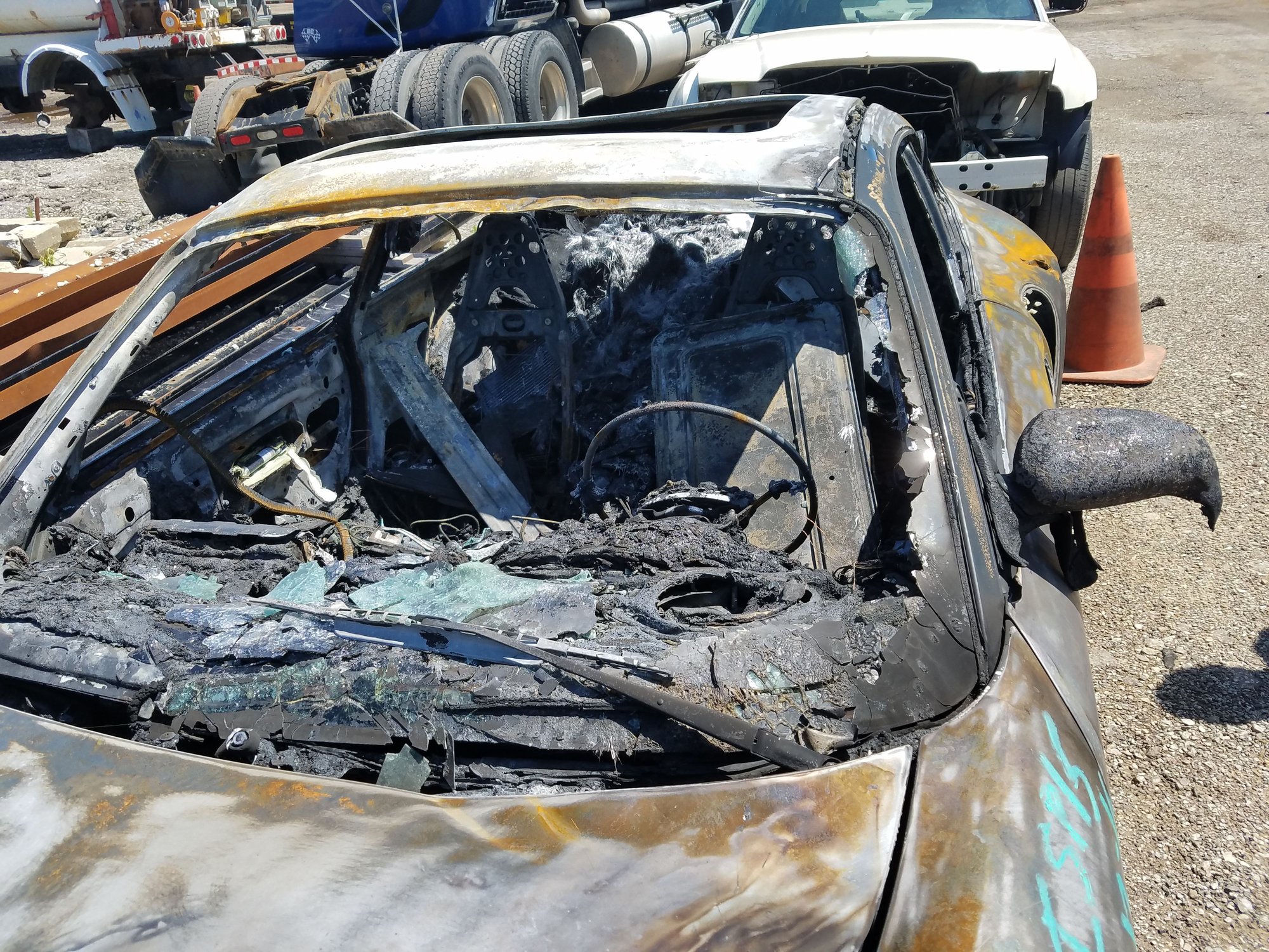

I appreciate everyone's kind words. The insurance company took it out the tow yard and are having some engineer look at it. If I had to guess it's probably going to be a fuel line failure. The reason I say that is because I had the original fuel lines and also because the fire spread to the front of the car very rapidly.
Here are some pictures of the aftermath. After viewing the car today I had chills. Remembering how fast that fire spread I know I could have been a permanent part of this wreckage. I'm just counting my blessings.

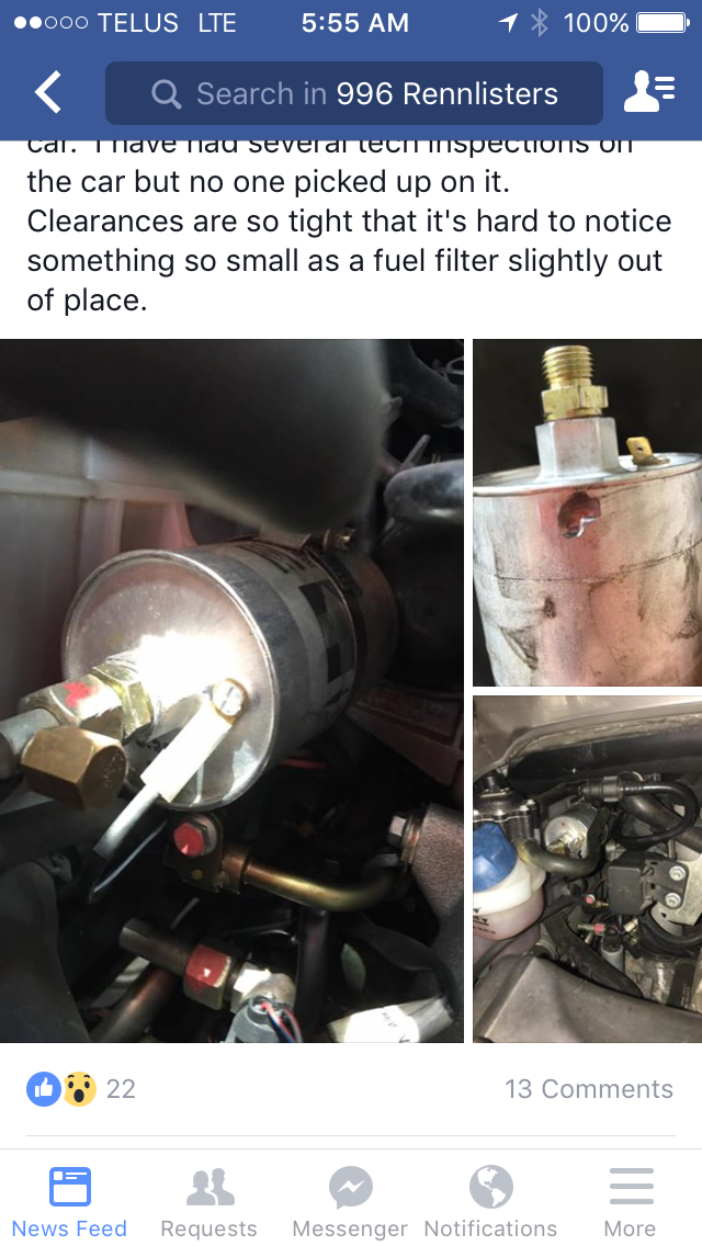

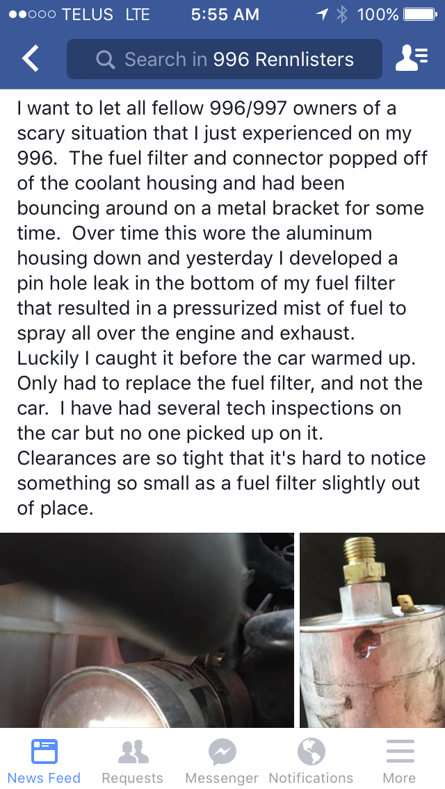

I just read this on 996 Rennlist Facebook. Op, you might find this interesting. Worth looking into for everyone else.
Wow that is interesting. I will definitely forward that on to the investigator to check out if there is anything to even remaining.
By the way the front of my car looks like that because the fire department was hitting to open the hood. The fire kept starting back in the front hood. They finally brought a second truck that had some kind of white foam to put it out.

condolences and agree you're lucky to have escaped without harm. those are the most shocking pics of our cars I've ever seen. here's to hoping your payout is fair. scary stuff, and yeah.. fuel for sure. my 914/6 did this decades ago.

Amazing to see absolutely nothing left untouched after that fire. Sorry about your car...
