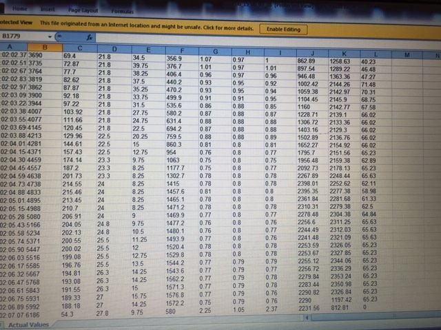

IC threads - love them lol
Im not here to compare them to what I make, but I've done hundreds of pulls and logs over the years. I just finished up a A2873 turbo kit, the bigger A28 set up, with our 4.5" race coolers... here is a 3rd gear pull I did about 6 weeks ago, I actually was heat soaking the car doing back to back 3rd gear pulls... you can tell starting intake temps are mid 40s C... yes it was hot outside too.. I didn't log outside temp, I was more after watching fuel and boost... well this car is running 1.65 bar, 100 octane, pump timing, durametric boost maxed out... and the intake temps went up only 3 deg in one 3rd gear pull. Granted, I let off at 6K.. but its on considerably bigger turbo, and considerably hotter temp... and alot more boost... and I did a back to back in the log... same result...
I just took a pic... for quick reference, but IM including the full log with 2 back to back pulls...
Im not trying to start online drama... but a 10 deg C increase at 1.3 bar on k16 billets is a lot of intake temp in one pull for the 5.7 wagners... they should be half of what they did...
just sharing my observations, and Ive been at this IC stuff since 2004 on my own 996TT... but Ill also warn that intake temps are half of the story... coolers must flow too...
link to full log
https://www.dropbox.com/s/rsk2zajwdw...boost.xls?dl=0

and a follow up:
I tuned this car with bigger K24 biilets, 4.5" ICs made by another company... and the intake temps roughly are half of what the wagner 5.7" show from 3K to 6K... just to be fair and not sound like Im hating here... I know its all relative and there are way too many variabkles to be able to compare apples to apples...
here is a pic...
