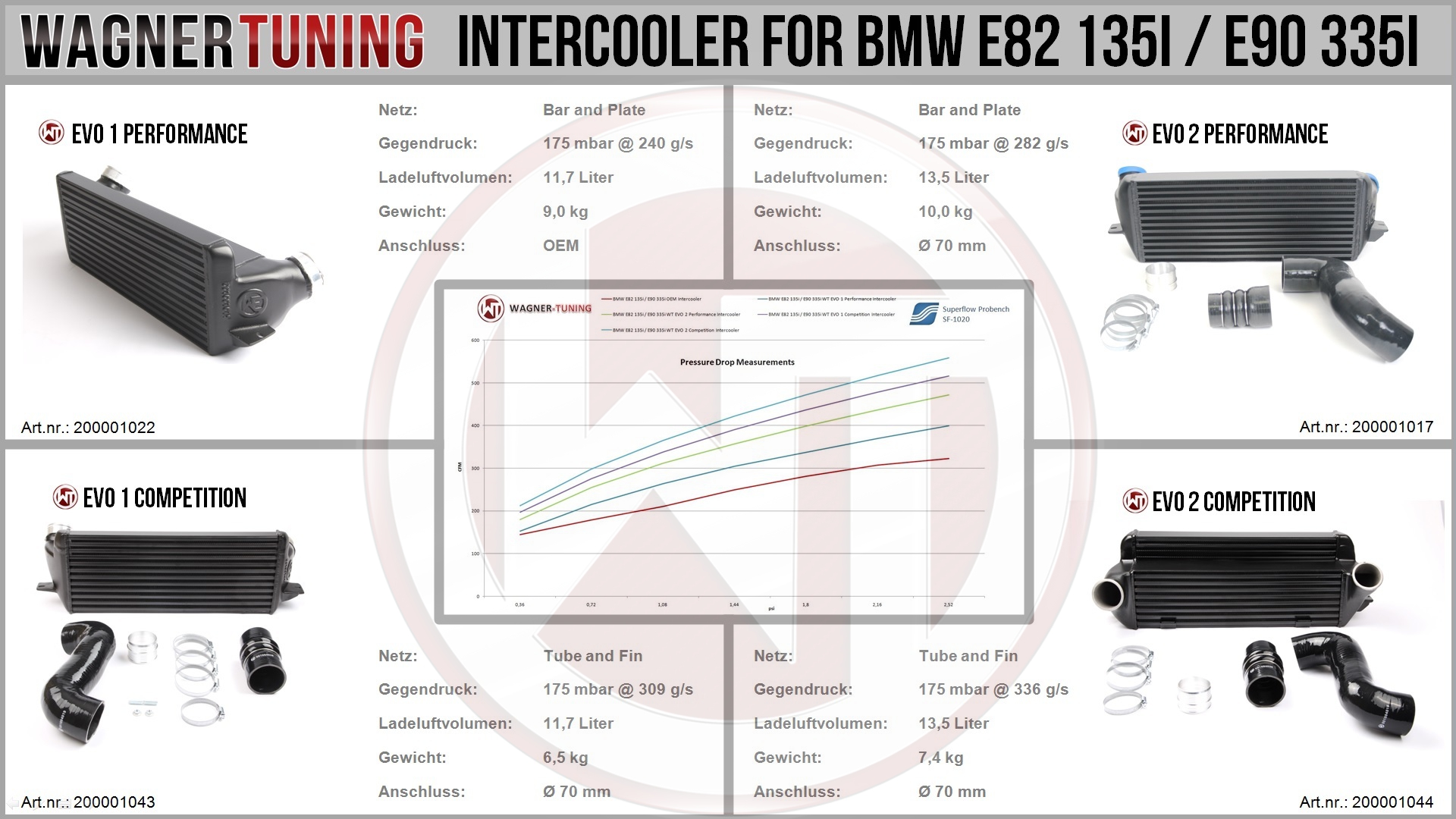

old wagners are bar & Plate and Wagners competition 2 are tube & fin...interesting data from wagner with a bmw 335i
