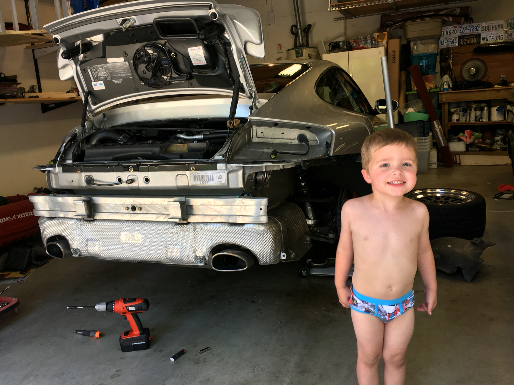

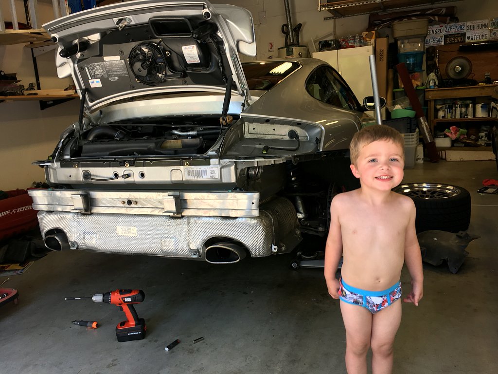

Sam, UPS man isn't here yet. But I'm ready.
Ironically the hardest part has been getting the hex bolt for the bumperettes off. Hercules must have put them on. I had to cut a Allen wrench and put it on a socket attached to a breaker bar to get loose

Get those rubber hoses off too. And clean the turbo outlet with brake cleaner for a nice grab when you clam on the new silicone. Dude you are looking younger each day
