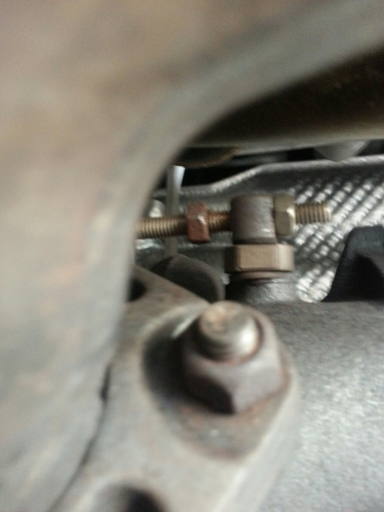

Originally Posted by HotRodGuy
Updates, I had issues with the connectors into the y pipe, I had to file the tabs down to get things to lock and not pop off.
I've got a leak somewhere still I think.
I dropped the car off at a local shop to do the trans and motor mounts (I'm lazy and don't like working under a car under jack stands these days).
They did a pressure test said it held 27 psi. But I'm only able to hit .9 bar. Should be 1.1/.2 with my tune.
I wasn't able to ask where they did the test from (picked the car up after hours)
Top photo is where the wastegate started . Bottom is final position.
Good news is I still haven't put the rear bumper on because my 3 year old has scattered bolts all around the house....
You don't necessarily have a leak. If you did a check and it held fine, I'm not concerned.
What other modifications do you have done to the car?
You may have to go in and manually tighten up your wastegates. With Sam's advice and tune, I added nearly 7mm of tension to the spring.
It worked perfectly and am able to hold 1.1 bar with no problems now. My car runs like a raped ape!
Top photo is original position of wastegates. Bottom is after adjustments
