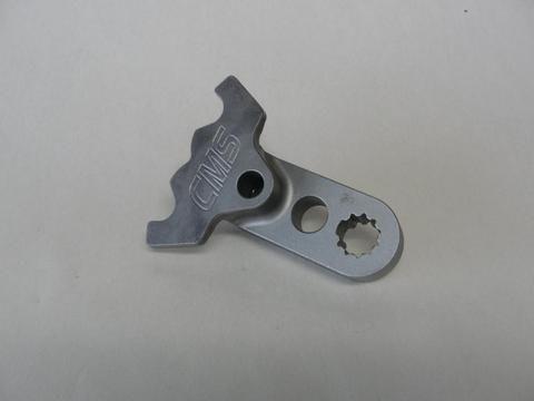

Well, I just rebuilt my transmission and had used that GBox's detent for five years. 2nd gear synchro's teeth were worn, but I did not have any issues with 2nd gear pop out. Neither were there any signs of other gear synchro mechanism damage. I replaced 1-4 gear synchros, 2-4 to steel ones because of track use. 5-6 were OK, no visible damage or measurable wear.
But, as the box was open, I changed that GBox detent to CMS's shift arrester:

I don't believe the Gbox detent increases the throw, it simply has more spring pressure. This extra pressure makes popping out of gear a little more difficult. This is definitely not a long term solution.
The CMS shift arrestor on the other hand is a better solution, but does increase the throws. BTW I have a CMS shift arrestor in my car and don't have any issues.

^ this. rebuild the box properly the first time or try the 8mm(?) ball bearing....detent is a stopgap at best. the "cms" arrester is a better piece, i am told.
