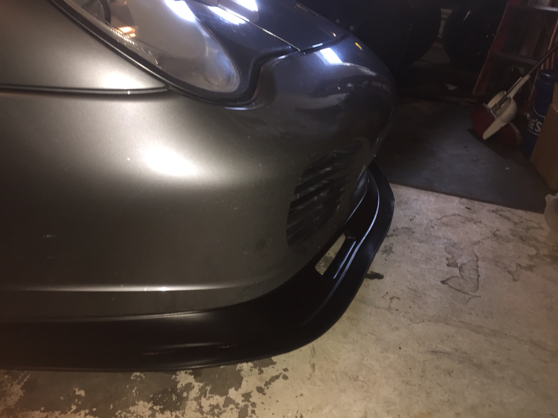

Use 1/8" UHMW sheet stock, very tough. I do something similar with the ebay turbo aero lip. I make a 2" splitter from ABS, it might improve aero a bit but it definitely makes it more durable and last longer. Click image for larger version

Originally Posted by z06801
Use 1/8" UHMW sheet stock, very tough. I do something similar with the ebay turbo aero lip. I make a 2" splitter from ABS, it might improve aero a bit but it definitely makes it more durable and last longer. Attachment 453968
This!
sort of what I was trying to describe
