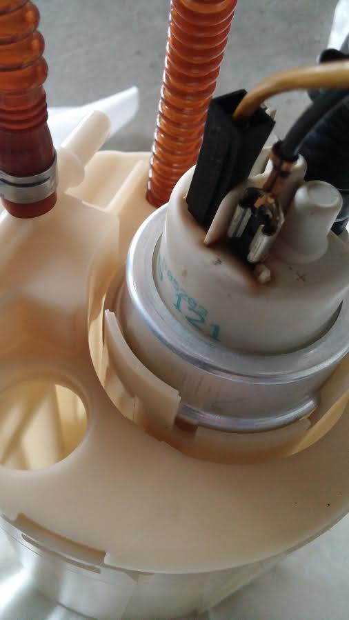

connectors, look burned to me.....maybe i'm wrong...
also second picture, not mine, why do we need to disconnect these lines? if yes, how. hard to reach. so i left them in the tank connected. while taking fuel pump out.
Hey do you see that L shaped fuel hose in that pic? It looks like its split of course the pic is blurry but if it is theres your problem. Lots of people have that hose split if its not then your pump is dead.

given their known and well documented propensity toward failure? i still can't see the wisdom of attempting to r&r the line and not just replacing the entire pump w a new one(?) which is probably ruptured unless you truly enjoy what in the immortal words of ray charles is doing the "mess around" lol..this'll keep ya in the garage until the dinner bell sounds! but it sounds as if you're well into it and perhaps just the line can? be replaced. but never heard of anyone doing that either..

I ordered new pump. Either or that pump is 13 years old. Battery was 5 years old. Second pic [not mine. My rubber lines are fine. ] i marked in square. And asking why ppl disconnect those extra venturi lines ? Whats the point? I just pulled two connectors on the back of the pumped and pulled it out
