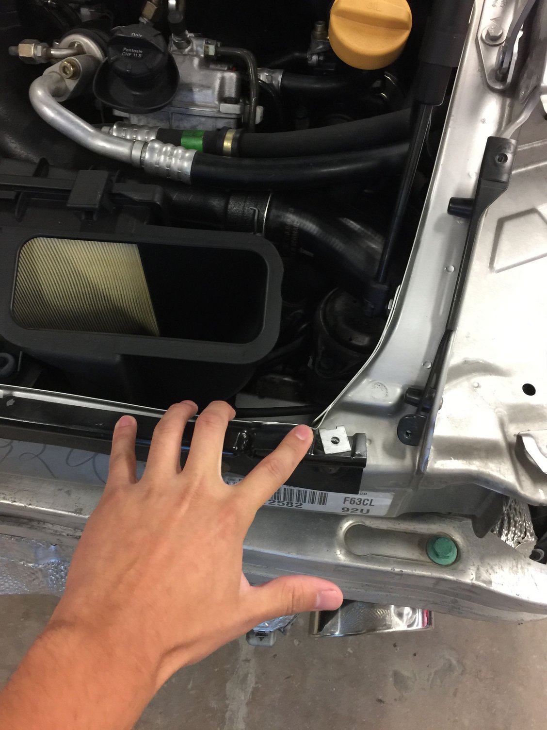

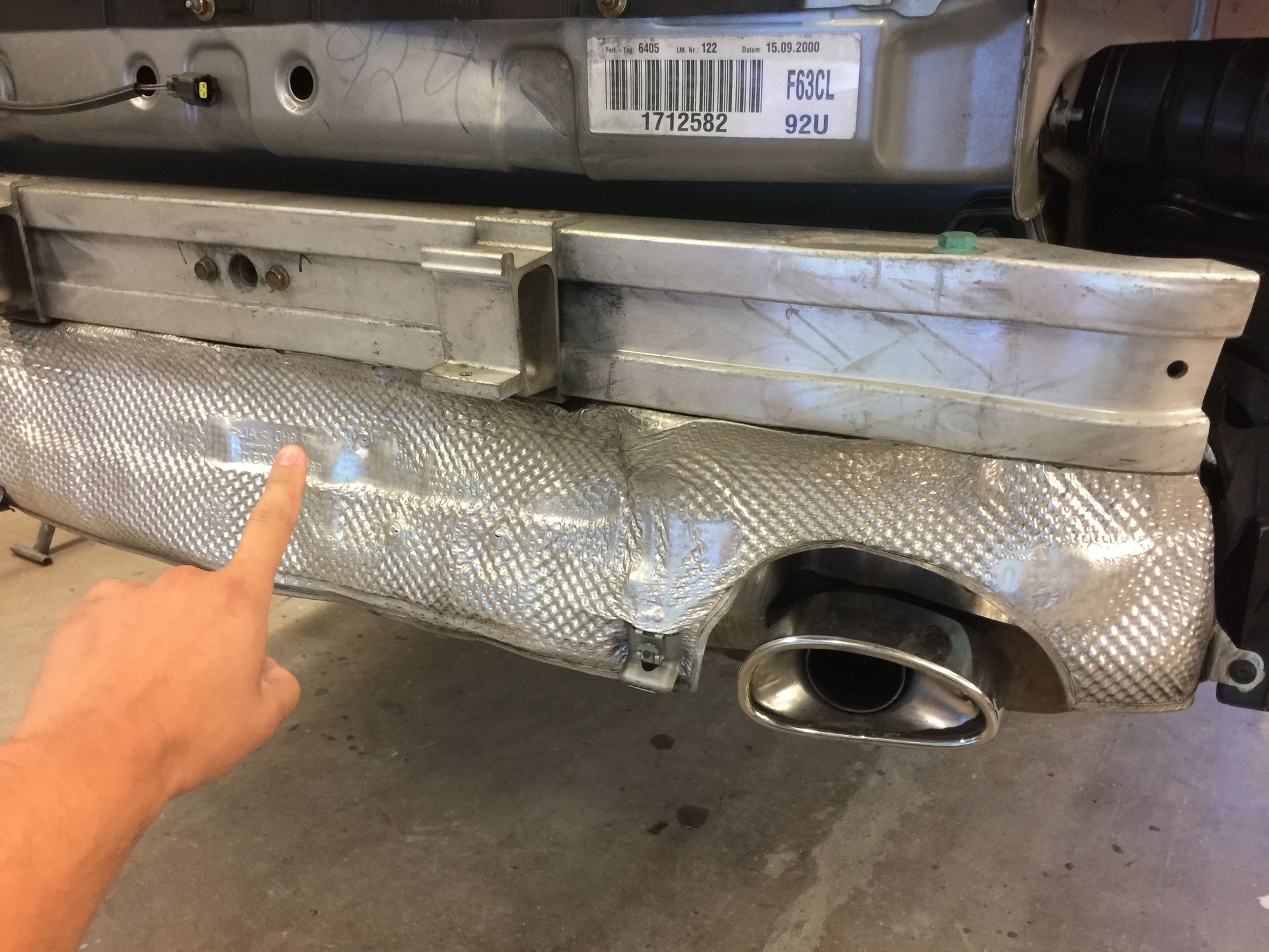

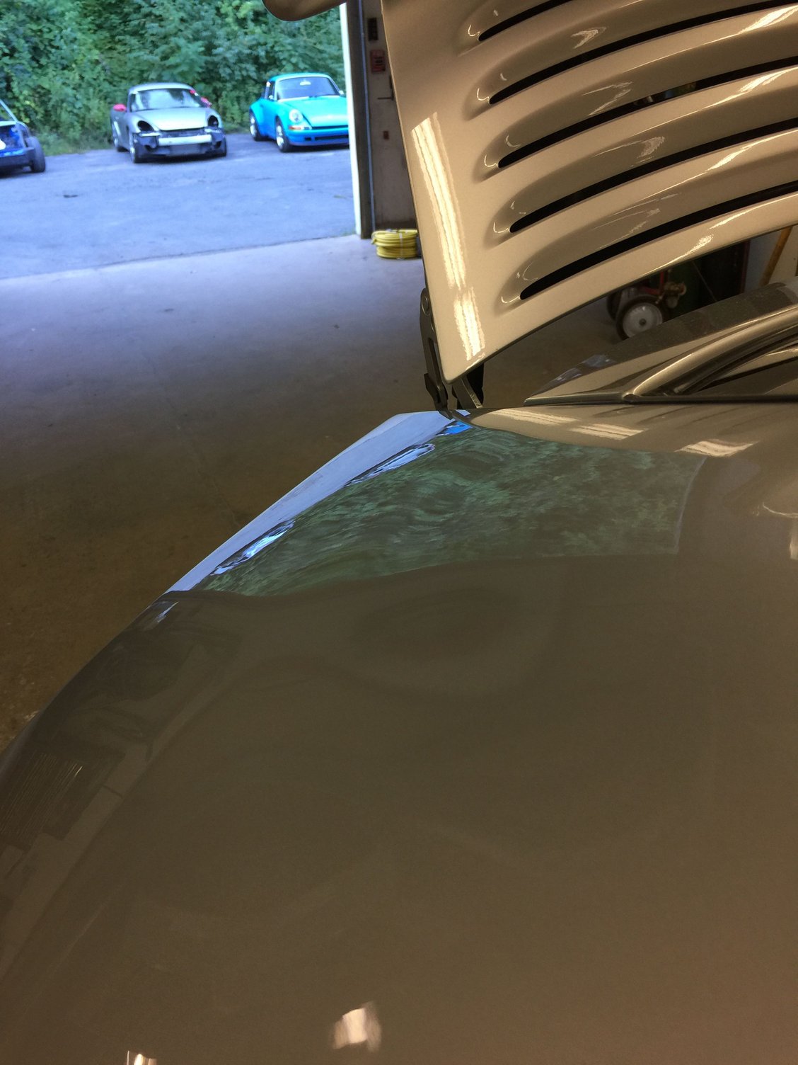

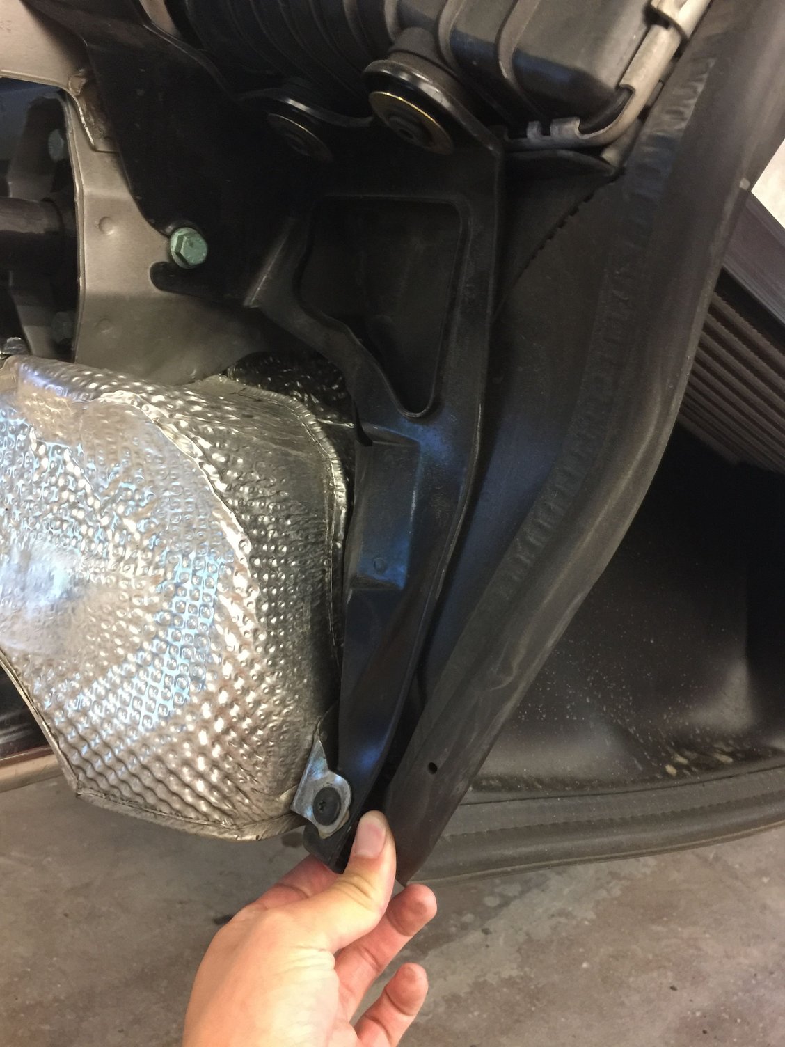

Update!
Hey Everybody,
Thanks for all the comments and advice. Here is a much needed update!
I’ve had the car taken to Automobile Associates in Canton, they are a well-known club sponsored garage that has been around for over 30 years.
It turns out the damage to the car was very minimal behind the rear bumper. The car will need a new exhaust, bumpers, and decklid. Even though the right side of the car buckled from the impact there was virtually no damage underneath the wheel well, to the engine or unibody structure. The civic had hit the impact bumper in the perfect spot so it took the majority of the force from the accident. Here are the pictures:
Slight Pinchweld bend
Heatshield cosemetic damage, bent exhaust tip
Under exhaust damage from bending
Cracked Plastic Intercooler shrould
Slight distortion in sheet metal...see Tree image.
Impact Bumper Piston Travel
There is some distortion of the sheet metal above the impact bumper you can see from the pictures. The factory seams at the decklid opening for the pinch welds look great except for one little gap. The force that caused this minor distortion above the impact bumper in turn caused the exterior sheet metal above the right side fender to push forward taking the path of least resistance and causing the car to buckle on the under the side scoop due to the hollow spot underneath.
Contrary to popular opinion the shop and insurance company believe car can be saved. Total damage estimate assessment is over $22k at the moment….Scary yes! But a lot of that has to do with the fact that New OEM Porsche parts are astronomical in price. A Honda Civic, for example in the same condition would have been $7k for repairs including half respray of the whole car. It also helps that these cars are no longer depreciating and it would have taken a lot more to total it out.
So after much debate, I’ve decided I’m going to keep the car and make it into a full build. The shop is throwing it on the frame rack this week to pull the body square and is confident the sheet metal skin will revert back to normal. I’ve ordered up an aftermarket exhaust and am going to push for a full respray!…StayTuned
