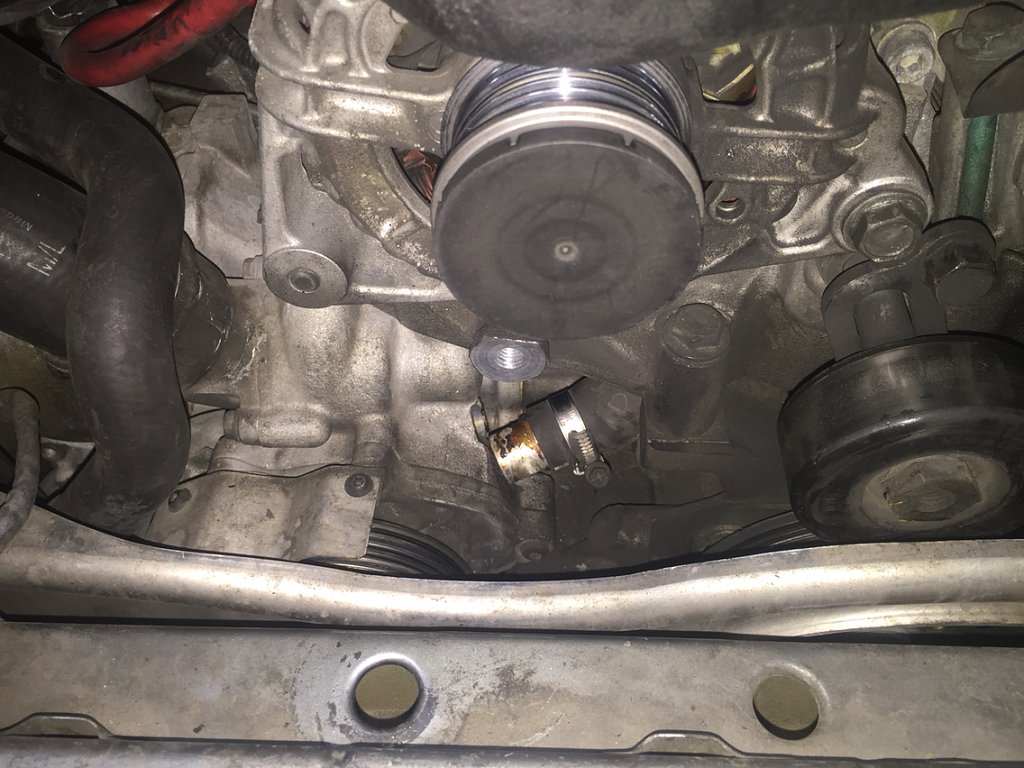

Another coolant tube victim
Not trying to create another coolant tube explosion post, just giving everyone an informational heads up. My 02 TT is for the most part a DD. (As long as it's not raining, which doesn't happen really all that much here in SoCal)
I do however enjoy the weekend spirited drive in my backyard Angeles Crest Highway and occasionally the Santa Monica mountain roads. With that being said, I have always had the explosive coolant tube epidemic in the back of my mind while on those spirited drives. Well............, with 72K miles it happened.
But it happened while I was driving home from work at 9pm. Sitting at a stoplight!!! I wasn't driving the car hard, and it was plenty warmed up, about 30 minutes of highway driving worth. Sitting at a stoplight, I noticed steam in my rear view mirror. As I'm watching the temp gauge, the low coolant warning appears and the temp rises. I was able to cross the intersection and pull over and turn off the engine before the temp gauge moved much more.
At the rate of how long it took all those things to occur, and by looking at the trail of fluid, my thought was it was a water pump failure. Apparently not.
Again, just informing people who may have that same worry hiding in the back of their mind. I don't track my car, and the burst happened while I was sitting at a stoplight. I knew that it would eventually happen, I just figured it would happen while pushing the car hard up the hill or downshifting around a corner. Not while sitting at a stoplight.

Do you know which tube popped out? Just wondering is some are more prone to this than others.

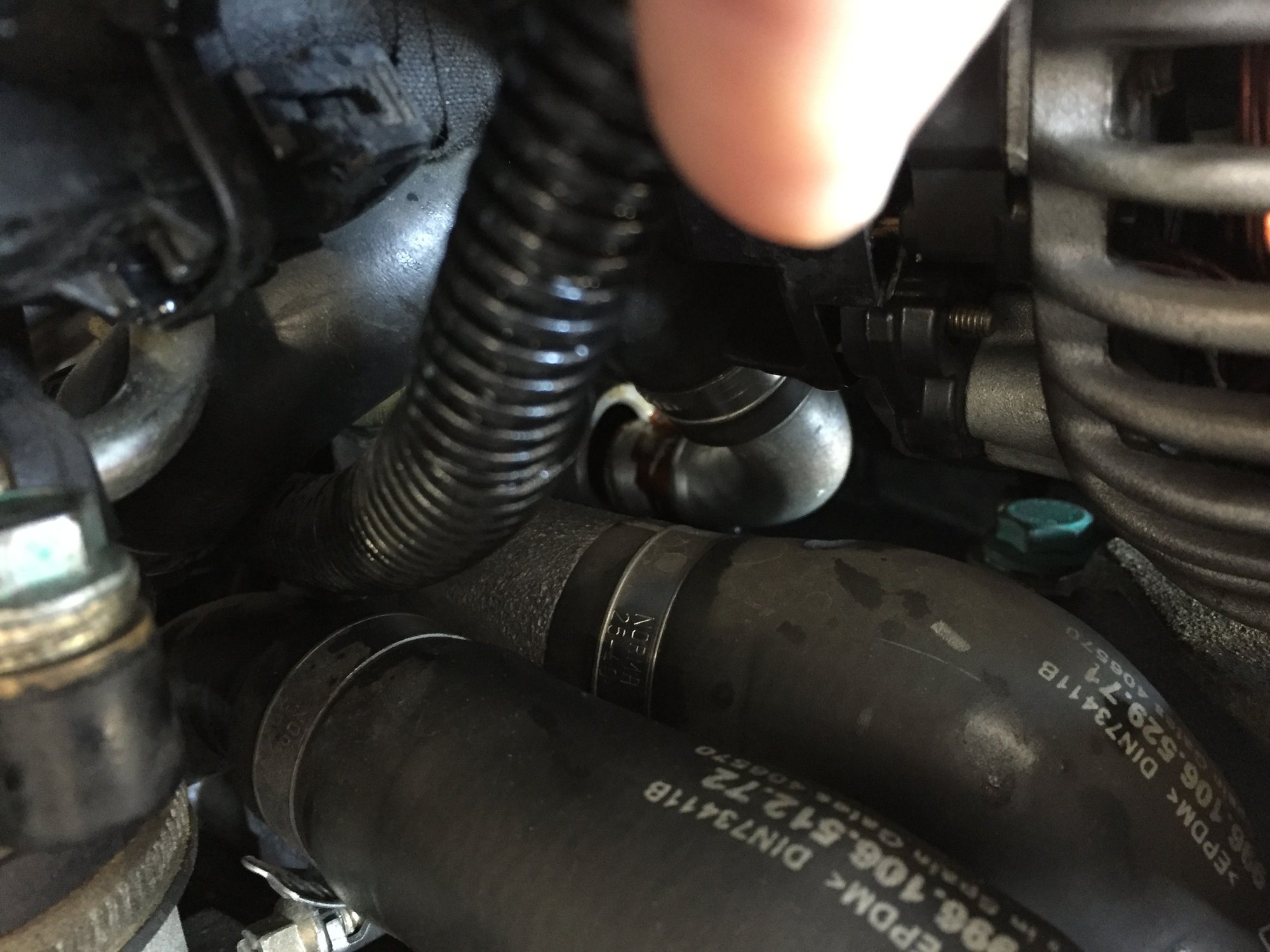

Hey I'm in the same boat. Two weeks ago I drove mine down to SoCal for some business meeting had a lot of chasing around to do down there and thought it would be fun to have the turbo. Coolant pipes were the last thing on my mind because 5 years ago I had bought the Torque Solutions 8 piece fitting kit and paid a shop to lower the motor and weld them. Turns out almost none were welded and I found myself on the way to a meeting stranded with a popped fitting I've been driving and tracking the car for 5 years thinking they were done. Click image for larger version
ID:	464516 Car is still in Encinitas

^Wow, that sucks that a shop didn't make good on said repairs.
For the OP, with the engine out and in regards to the clutch. You could do a minor refresh of it by just changing the disk and nothing else. It's no more than 30 minutes to do this job with the engine out.
That's unless you're looking to upgrade clamping power for future upgrades.

Did the shop just glue the new fittings back in ala OEM treatment??
This is the one that popped on me:
In addition to all the previous small things I will replace, the clutch accumulator is also on the list to be replaced

not that i would say to do this as permanent fix but you can actually get to that fitting without dropping the motor to pin . it. may help you get your ride back on the road and allow you to wait until the remodel is done to start a porsche remodel.
oil temp sensor, intake manifold rubber gaskets, fuel filter, coolant tank reservoir are all things i would look at replacing if you do remove the motor. also if your going thru the trouble of removing the motor i owuld suggest welding the fittings vs pinning. eliminates any chance of future leaking and ypour going to do a water pump anyway.
