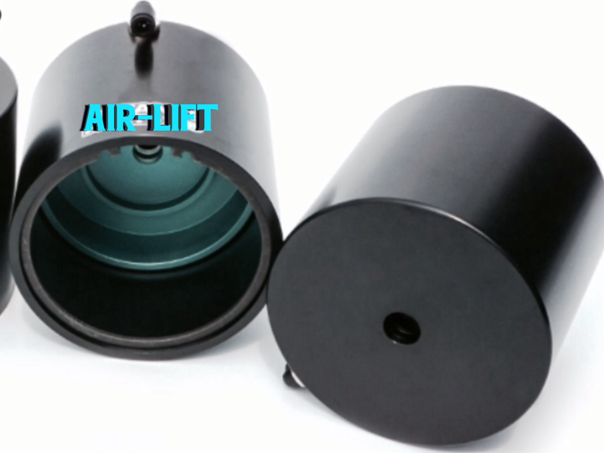

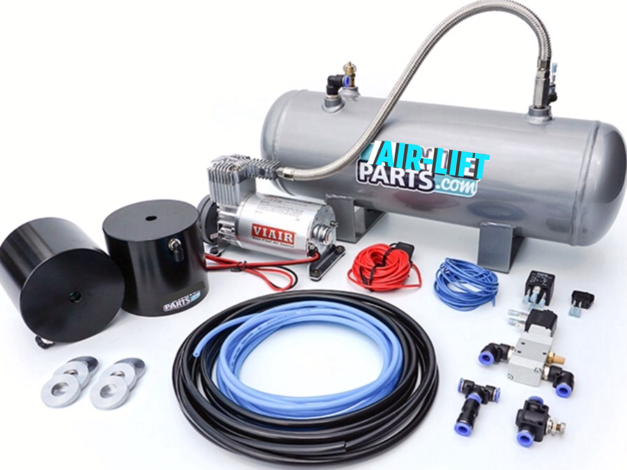

Pics I found, my airlift-suspension guy sent.

That's actually a nice system and makes much more sense to me than the heavy hydraulic systems offered by Tech-Art, K&W, and the like. I just hope you didn't install that huge compressor and the air tank...
And btw, your "Air-Lift guy" sucks at photoshop

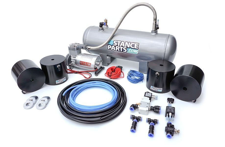

Also doing just a front lift is only about 400 bucks. Just buy the air cups from stance. Then cheap and easy to get a small compressor 1/2 gallon tank, air soleniod, and a 90psi stop switch

. I know right. I was cracking up when he sent me that. He wasn't even trying hard. Lol
The pic was for like a truck setup I think. Those cups looked huge so when I pointed that out and the size of the tank he came back "with you get smaller cups and tank and it will all be in a hidden box in the Frunk". 2 lower profile tanks, no taller than the pump so it wouldn't take too much of the storage space.I didn't mind the price considering all the custom work he would have to do installing and hiding it all. He promised a working system all hidden.
Yes, that is what I am planning as well. There are other manufacturers using the same "air cup" design.
As I was toying with the idea, I came across CF air tanks such as those used for paintball. A 90 cu in / 4500psi carbon fiber air tank weighs under 5lbs and should hold enough air for several dozen lift sequences. But you'd need to purchase a 4500psi compressor. And I'm not sure if you wouldn't need to stick one of those green diamond warning signs on the back of the car. LOL
What I don't like about the Stance parts, btw, is the 50mm lift. I don't need 2".

Yes, the K&W setup is silly expensive. And if you were planning on doing a 4 wheel lift setup, the kit is €950 retail, so he's being more than fair. Rear shouldn't really be necessary on a properly set up car tho.
Actually, that's not a truck setup - that is for regular coilovers. The standard air cups are only 110mm (4.3") in diameter. And the springs can't be larger than 89mm (3.5") diameter.
https://www.stanceparts.com/air-cup-lift-system/
