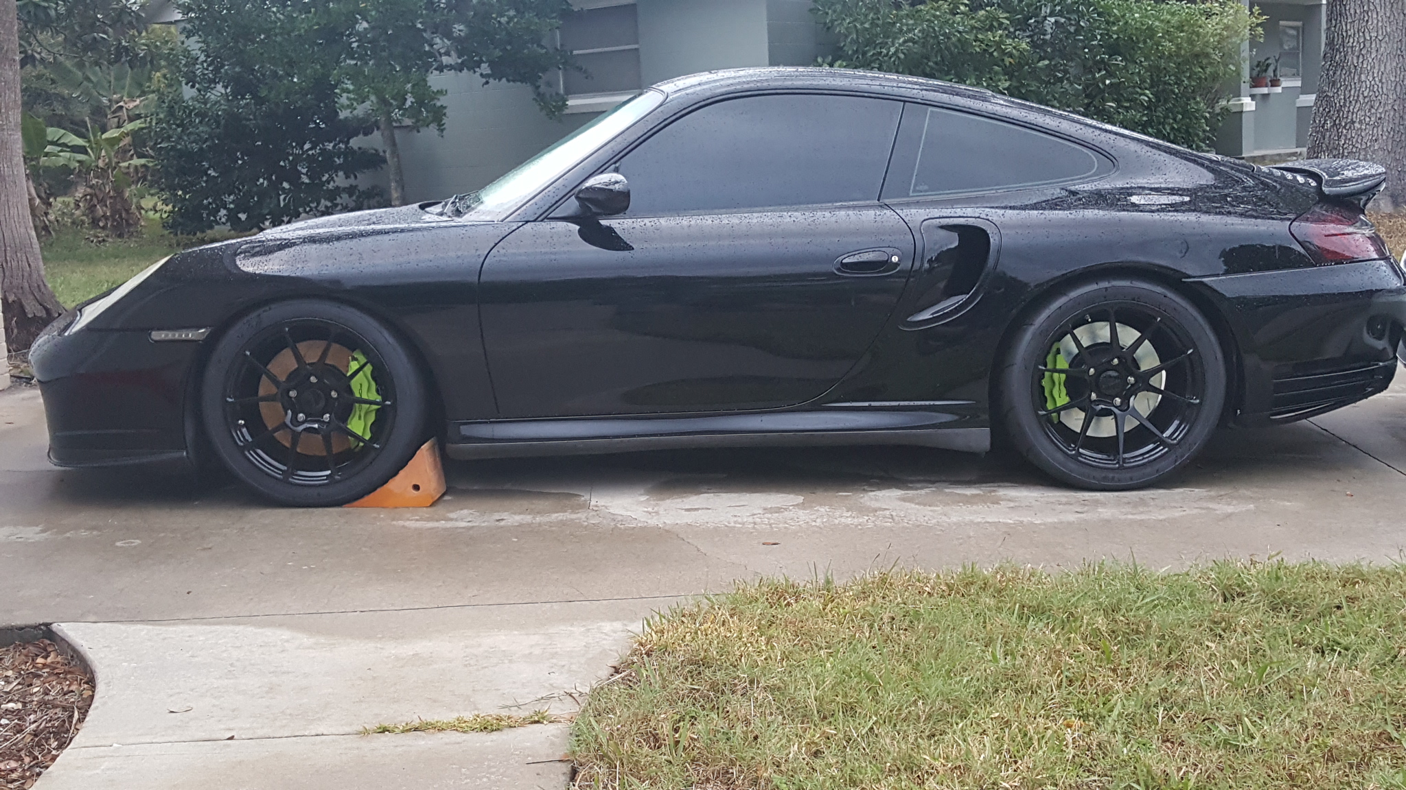

I just did mine and it wasn't really that hard to do.

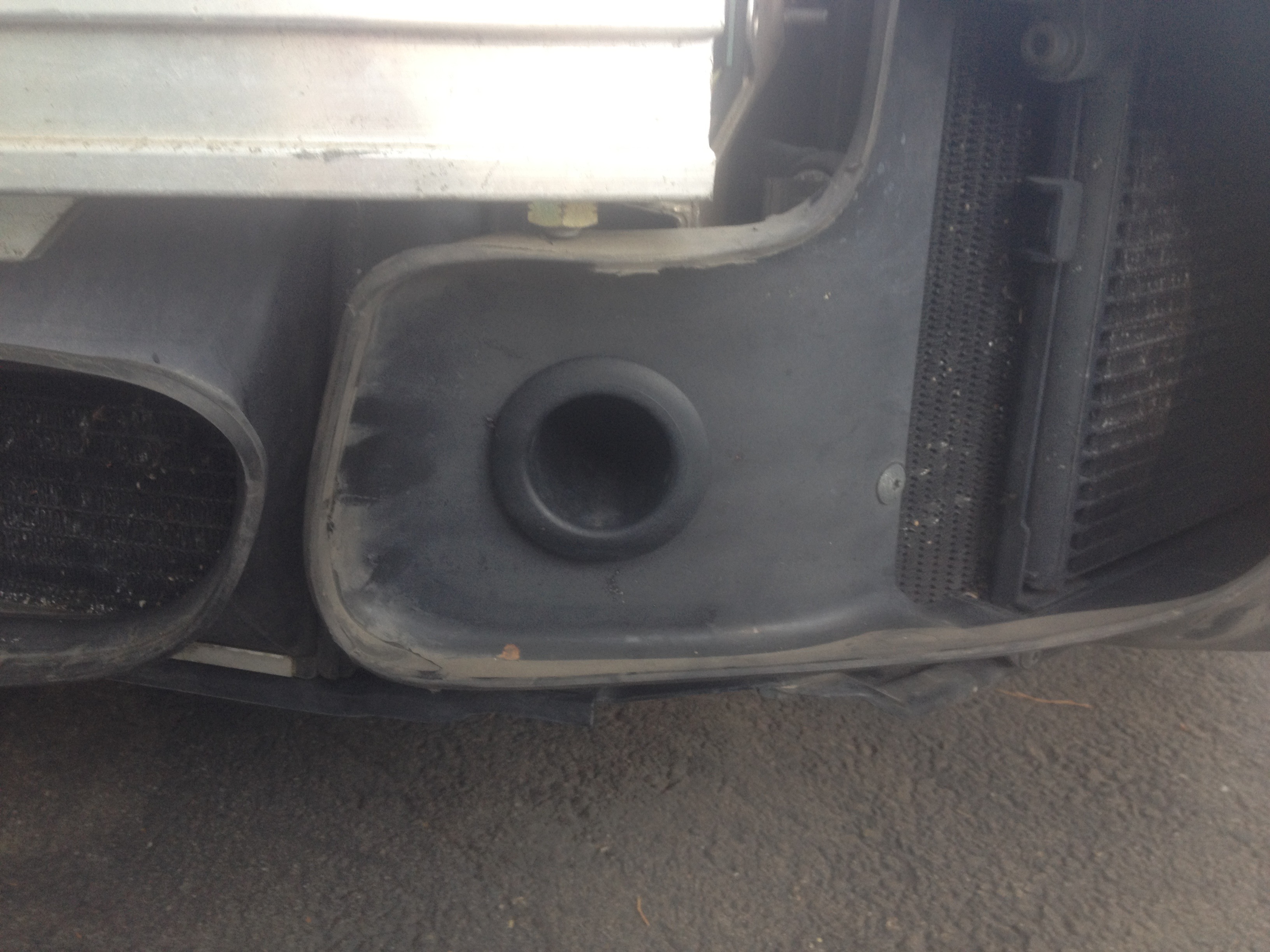

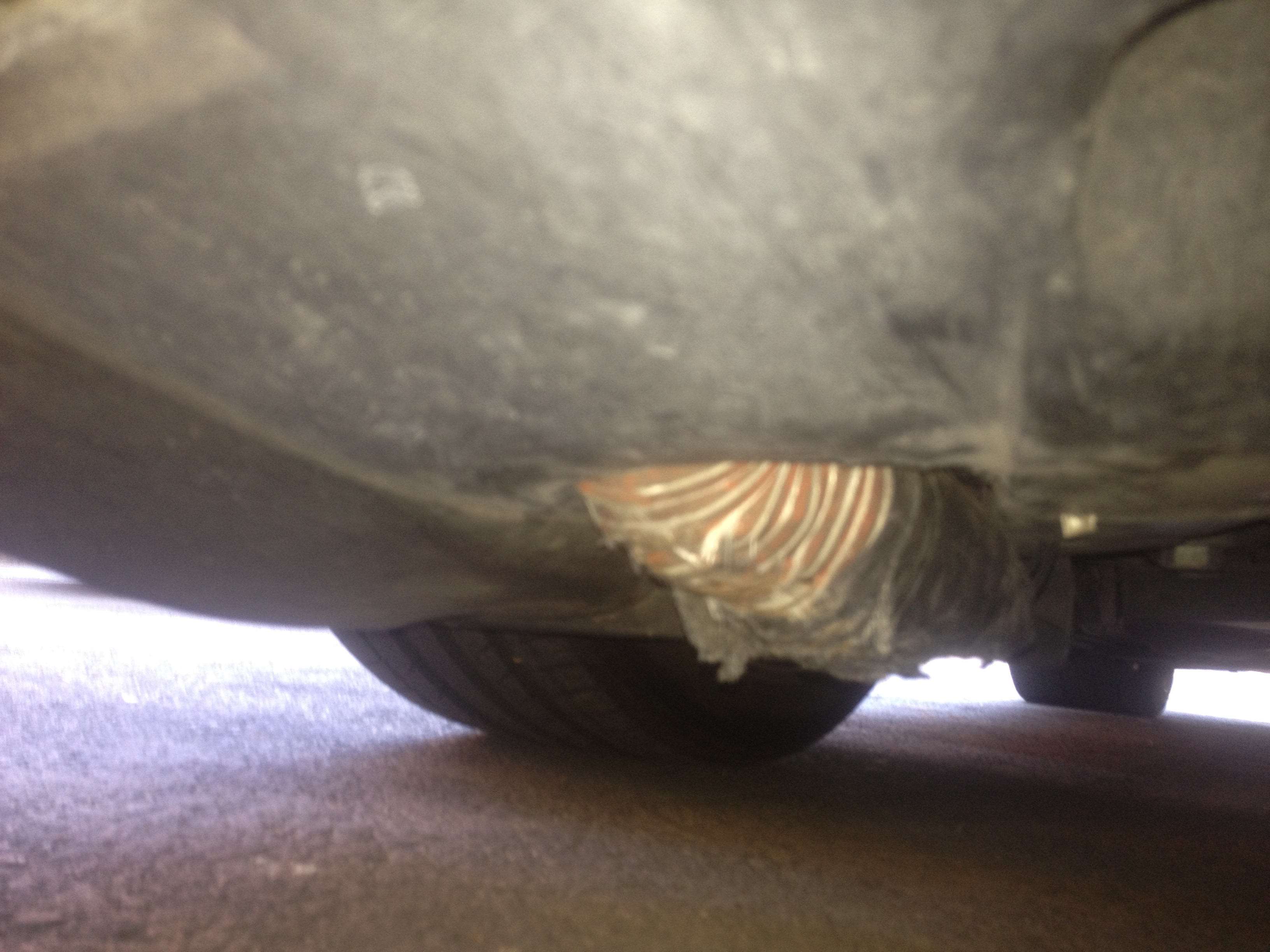

... though in fairness, i DO have some add'l brk ducting with a/c hose running from my fascia directing any add'l airflow to the calipers.
whether or not this helps cools the pads/rotors etc? i dont know for certain,.. but it can't hurt.
and this is what it looked like BEFORE i replaced it which is a bi-annual event! lol

Old Jan 14, 2017 | 08:14 AM
06Turbo's Avatar
Joined: Sep 2010
Posts: 234
From: Los Angeles
Rep Power: 43
06Turbo has a brilliant future06Turbo has a brilliant future06Turbo has a brilliant future06Turbo has a brilliant future06Turbo has a brilliant future06Turbo has a brilliant future06Turbo has a brilliant future06Turbo has a brilliant future06Turbo has a brilliant future06Turbo has a brilliant future06Turbo has a brilliant future
^Sportec Brake cooling ducts? Or home job? Do tell!

shop job by a shop you should know about in la. speed gallery. looks much better with fresh ac hose. i just didnt have a newer pic lol
