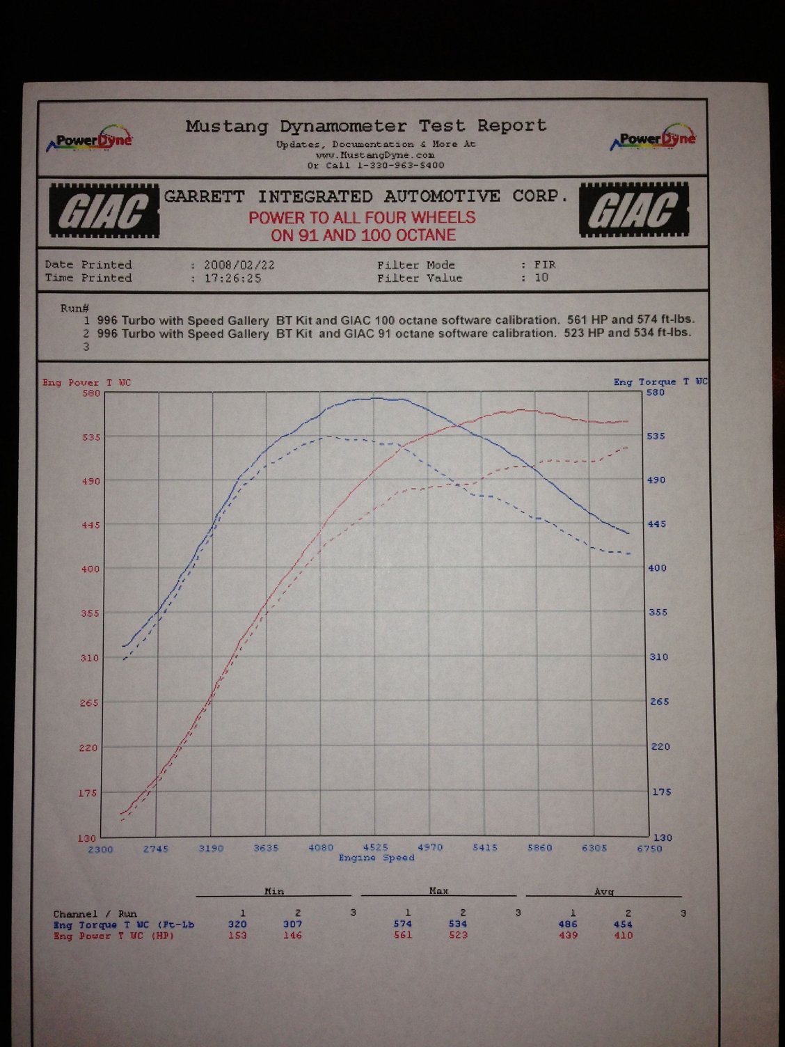

How many ft-lb max to stock rods at the right range of RPM? I have heard that around 620 is ok. Any experiences?
Old Jan 25, 2017 | 07:08 AM
pwdrhound's Avatar
Joined: Jul 2010
Posts: 4,848
Rep Power: 457
620 should be in the ballpark with a good tune. As a data point, here is an old dyno of my K16s on stock internals, 1.25 bar, 91 octane, 100cell RUF exhaust. Ran it HARD at the track like this for 2years with zero issues. Torque was specifically detuned down low to protect stock rods with peak torque of 631 ft.lb at 4600. When the engine was taken apart, everything looked great including rods. After we rebuilt the engine and added rods, torque was increased another 50lbs and shifted 500 rpm left. Good programming tailored for your specific use is the key to a healthy engine. Bad programming on the other hand will blow your engine even with less torque. Sam will take care of you for sure....

Hey Sam,
Those turbos look great. Slick waste gates! Quick question, why are all the dynos cutting off at 6300-6700 rpm? Redline should be 7000-7200 no? Just curious what happens to the HP/TQ curves in the last 500rpm at redline. Hope all is well on your end and 2017 is treating you well so far!

Originally Posted by pwdrhound
Hey Sam,
This is common, it's generally the guy running the dyno not wanting to blow up a $30K engine as well as not knowing the rev limiter is lifted.

I dont have k16 anymore. I use now k24 with some freaking new milled compressor wheels size 49,5 mm (guess stock k24 are 42mm). The car gets tuned tomorrow and i know the Torque gets limited to 620. So all good. 1.5 bar boost...yeehaa!

Yeah hard to control dyno's done elsewhere. I'll get a 996 on soon for verification.
