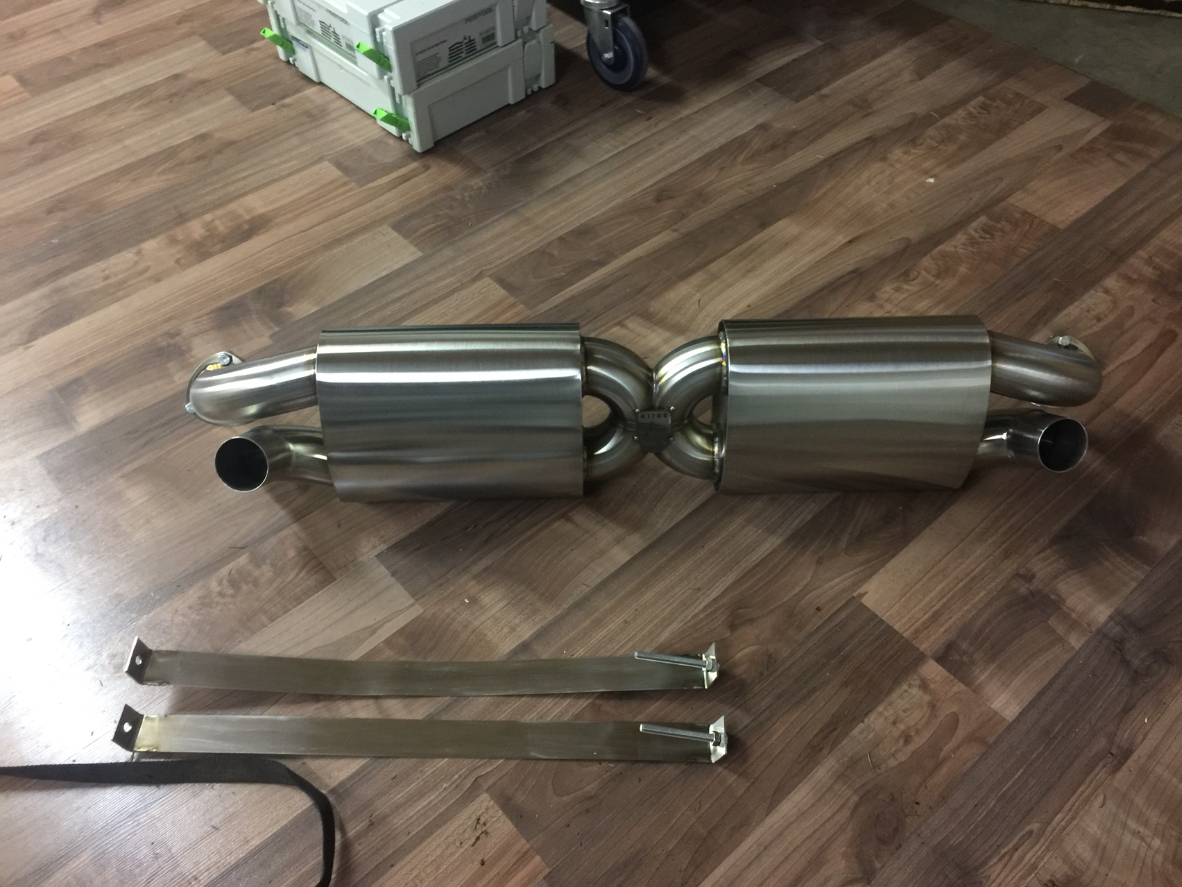

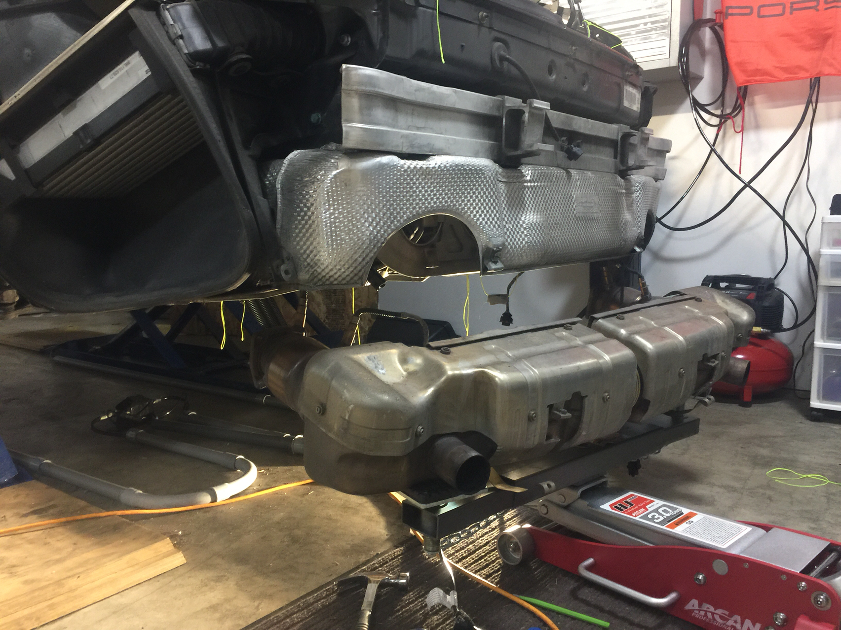

2nd,3rd and 4th about good ole Sam. He is top notch. While I don't have the technical know that others have I do know that I'm very satisfied with the mafless tune he programmed for me. The car just screams (that's as technical as I get)
As for the service I don't know how he does it. There must be like 4 of him answering everybody's questions. I have emailed him at 11pm on Friday night and seems like before I press send he's already responded. I have never talked with him personally but the suggestions and help he's given me, nearly instantaneously, via email is mind boggling. I also know that if I really needed to speak with him he'd be there.
I can't say enough about how he talked a very conservative "tooth driller" into a mafless decatted Kline. I had my reservations but whenever I stomp on the pedal I get a big grin!!!

more pics of that exhaust install please ( I have one just like it!)

I was in such a rush to get it done that I didn't take any pics. Once you get the stock off. I can tell you it's pretty easy to get the Kline on.
1. Start by installing the o2 sensors being careful not to get antiseize on the tip (ask me how I know).
2. Loose fit the decatt
Then strap the xpipe up which is not to difficult. I used a floor jack and a crossmember I bought at harbor freight for 20 dollars. You can see it under the stock exhaust photo when i removed it. Bolt goes in the top and then you can loose fit that also.
3. xpipe lifted with the jack apparatus. Loose fit the xpipe to the decatt.
4. Tighten up everything remove your airbox and fish the o2 sensor wires up and reconnect.
5. Buy accessport from sambo if you haven't already have him do mafless tune
6. Retune and go for a test drive. Hold on and enjoy the ride
7 get back home take take off wheels go to Home Depot and make your turbo pressure leak tester
8 probably find some leaks. Ziptie what you can till it's button up
9. Put all back together. Get on freeway ramp. Stomp on pedal and boost to 1.0-1.1 and watch out for cops
10. Pm me if you have any questions.
