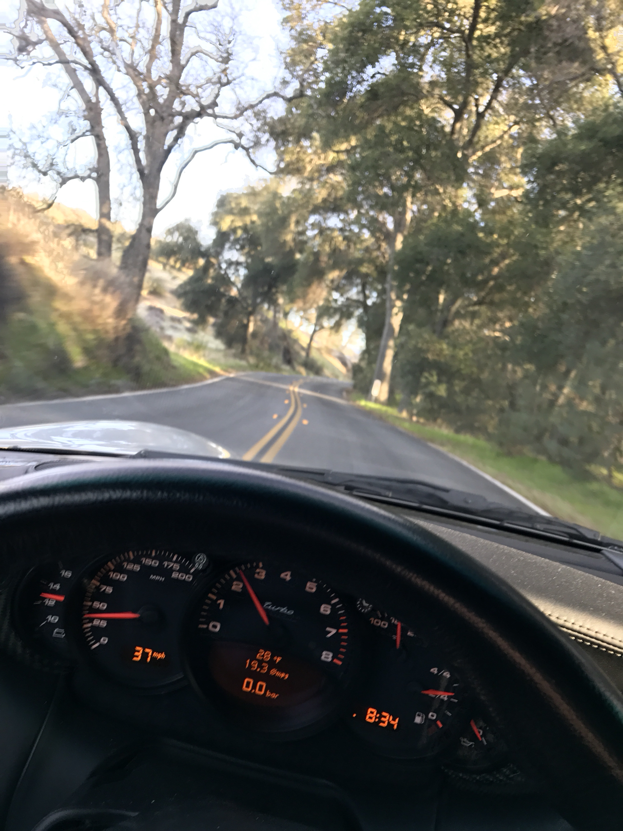

By the photo you have of the instrument cluster, I noticed your battery voltage isnt much over 12 volts which points toward alternator being a potential issue. These cars are very finicky when it comes to voltage especially when pushed at WOT..

Also your oil pressure is low. Do you have any issues with the sending unit?

Yea the unit needs to be replaced. Goes off and on. I've been told it's common and. It to worry. Will be getting replaced soon when I do the clutch.
Good catch, I'll keep an eye on it

So just hooked a volt meter to it. At idle it holds 13.7. Can't drive it around today but will keep an eye on things

It always reads high until you go for a drive then it will drop to 12s which means your alternator is going. Happened to me.
It's a 12 volt system. 12-14 volts is what it should read dependent on accessories running.

I have a new bosch alternator and see only mid 12, maybe sometime 13 volts driving. That means nothing as it's a 12 volt system
If it sporadically jumps on and then off it's the connection itself. It's just a spade connector like a speaker. You can pull it off and crimp the ends a bit and reinstall and it should return to normal.
