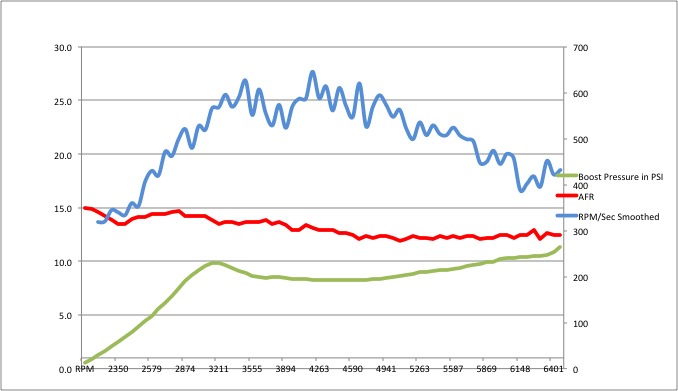

Hi all,
After much learning in the excel graph functions, I thought I would post my chart mimicking mbgt72's chart based on his amazing sticky.
Any takers for feedback on my findings?
Boost comes back up after dropping? Does this indicate a boost leak. I have pressure tested and only hear a faint hiss near drivers side throttle body after zip ties. Planning to pin the coolant lines and replace the leak prone valves, hoses, gaskets, ect.

read the durametric sticky at the top. Tighten everything that leaks until it holds 20psi.

Zip ties? Oh my.
What jdexter said.
