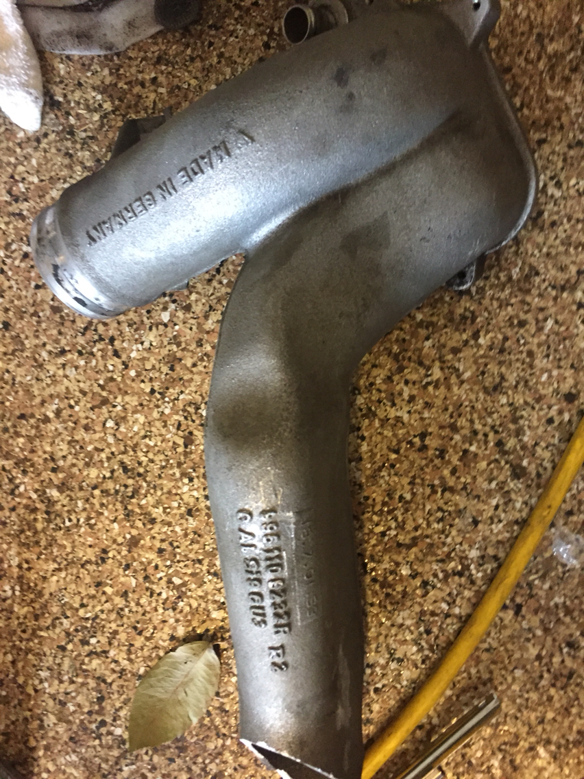

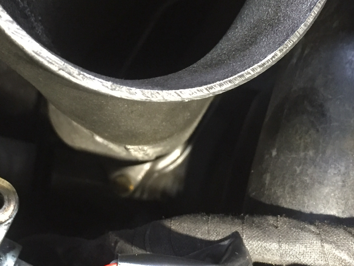

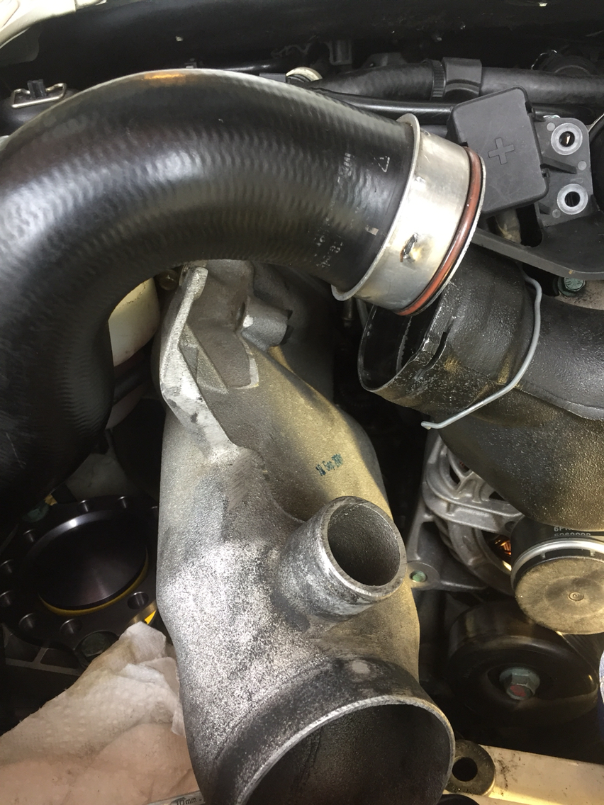

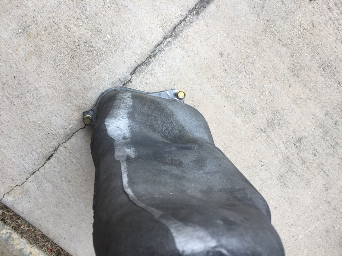

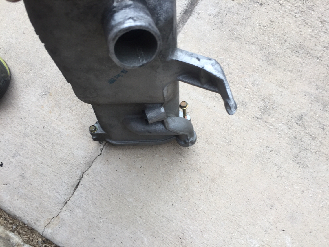

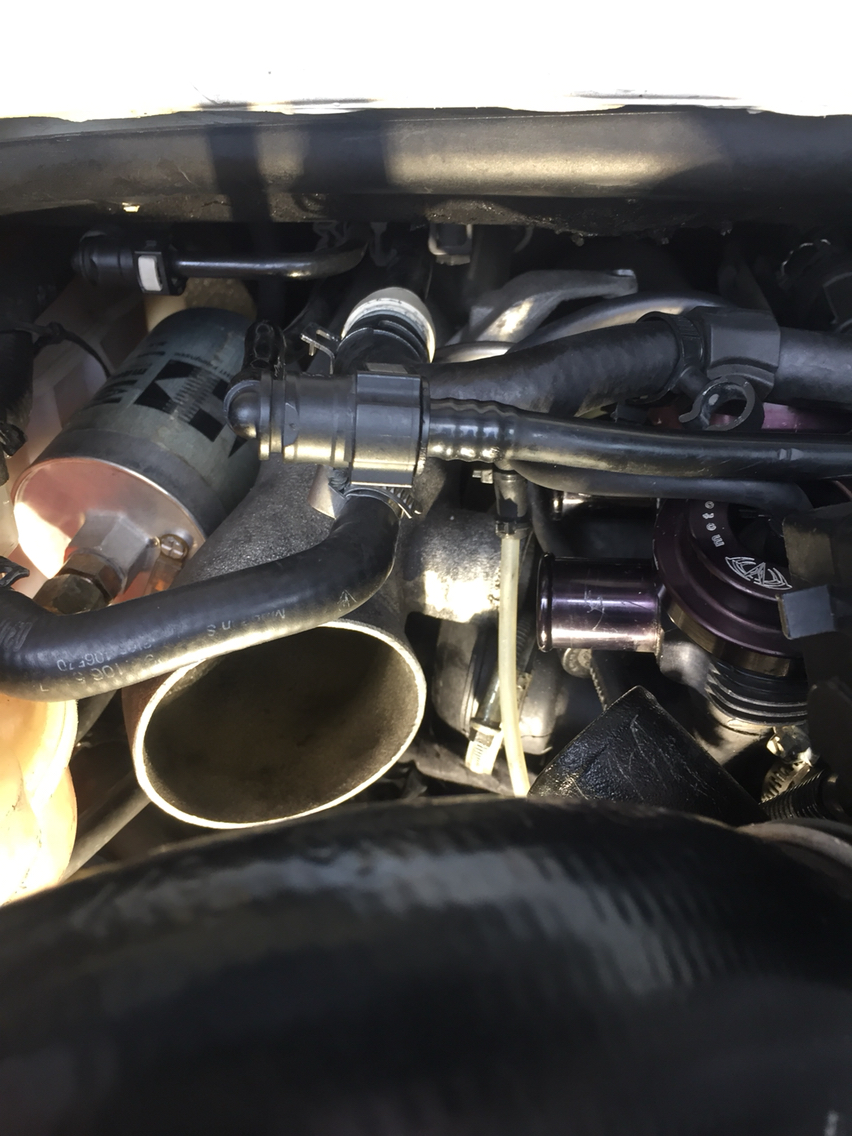

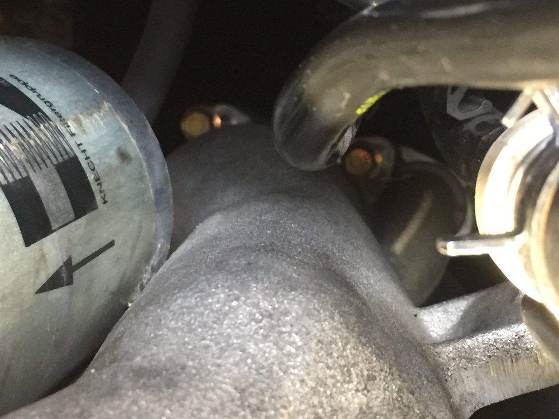

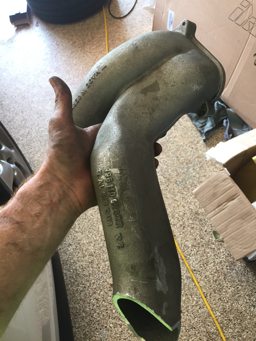

It's a semi annoying job, be careful take your time and use short blades. Lower the engine as much as you can.
Hope some of the pictures below help. The plastic side comes out with one cut near the axle.

What shall I use to cut the pipe with?
I couldn't fit an angle grinder behind the engine, its too tight
