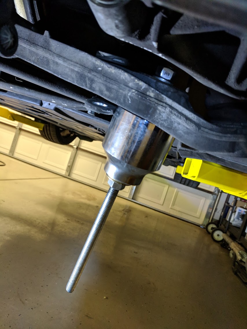

Finally got around to installing this after many moons. Worked out great!
Straight line stability is much improved from what I can tell on my commute. I didn't get crazy but I especially noticed it under rev match braking on a freeway off-ramp as the rear end stayed more true. No real additional NVH to speak of which alleviated much of my concern with the solid bushes.
The stock bushing were definitely worn as they showed to be deformed off center when pulled. I have ~50k miles on my 2003. I can only imagine how much deflection they were inviting under load. Hopefully, tire wear will improve beyond the 8-10k I get per rear pair.
Pulling them on car worked out great with the tool I improvised. Luckily I had a huge 54mm socket. I also made a 54.5mm press die out of 1"x1/4 steel stock to press out the 55mm diameter bushing. And some 1/2" all thread.
