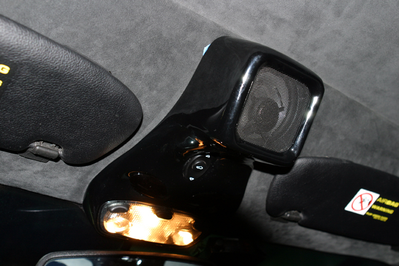

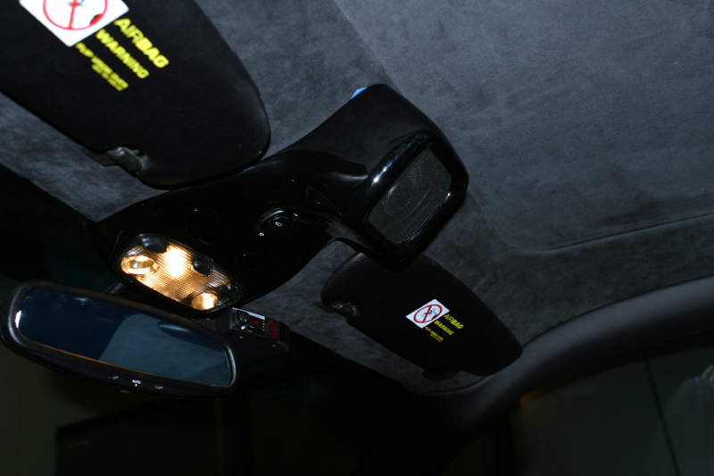

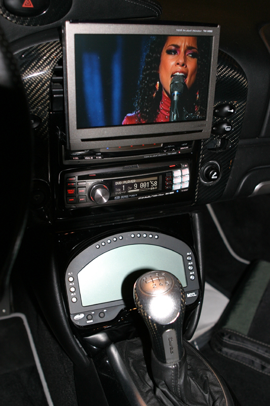

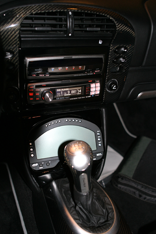

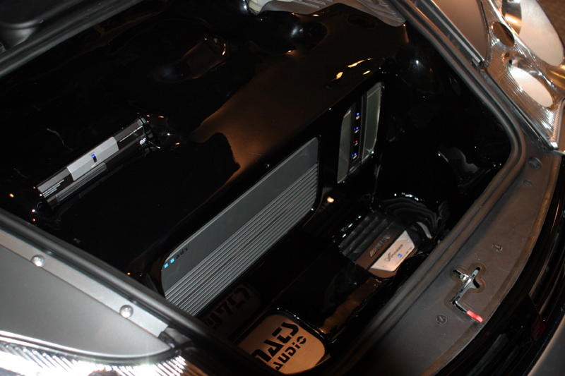

Here are the pictures of the finished product, the quality is perfect.I am leaving the car of tuesday all day for the final adjustments to the Road EQ and the digital Crossovers etc. It takes all day to adjust this system. The sound quality is amaizing. The Amp rack and Center channel pod where both custom made and took several days to complete. The complete install took ten days, the whole interior of the car came out and all the wires where placed along side factory wire harness. (excellent work).

I really love the trunk set up, looks nice and compact.
I opted on Double Din, to slot in so that it wouldn't cover the air vents, but still looks good! bit more visible to the cops though if they were to pull alongside. What is the law in US, are you allowed to drive with visuals on?
What is built into the light console?

The piece built into the light console is the center channel speaker , this system is Dolby Digital Surround EX/Dolby Digital Pro Logic II /DTS-ES with NEO:6 decoding and Digital time Correction to adjust for space limitations inside the cabin and has a Road EQ capable of canceling road and engine noise in real time.

Question on the install.... the amps are mounted to boards... how are those boards mounted? did he just screw into the car??

the pod for the center channel looks good, but a big question is the position of it for exact imaging... Did he not want to do anything to the dash?
