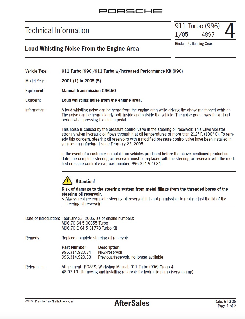

Check your power steering reservoir level. May be this help:
Name:	Screen Shot 2017-10-27 at 15.28.39.jpeg

In the case of my 2003 Turbo it was the power steering tank, well, the pressure control valve mentioned in the Tech Info.
Tech replaced the tank and the noise was gone and has not returned. That was at least 50K miles ago and could be nearly 100K miles ago.
Thanks this is what it looks like,is the reservoir serviceable or has to be replaced?
quite expensive though

Originally Posted by aiyer
If the sound is coming from the right side of the engine like a whistling sound, it is your power steering reservoir.
Had the exact same symptoms 2x. Once low on fluid... Once replaced reservoir. Problem solved ! Also low milage car at about 18k miles.
If the level is low, refill to top mark and try it! If the noise is still there you will have to replace the reservoir. The supersede number is 997-314-920-50 and yes it is expensive, around $600.00!

Exact same symptoms on my 04 996tt with 27k miles. However, I found a used reservoir top from a 997 and just replaced the top, and replaced the fluid. No more noise after 2k miles.

TSB 4897 the legendary PS res WHINE and dealt with by most older owners lol.
