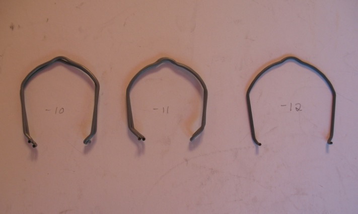

There is not much difference between the clips of different part number. But I know if you don't put the right one in the right place, it won't hold. The one you need at this location is 99610680211, and look how close the 10 and 12 are from 11!!!! I had that problem after engine removal for pipes welding and I was not able to pressurized the coolant system with air without having one pipes popping out!!! I bought new clips and position them properly, no more problems....I got new 99610680211 in my stock, I can take some measurement if you want...... the 99610680210 goes on the right side and the 99610680211 on the left side, you cannot mix them up.....

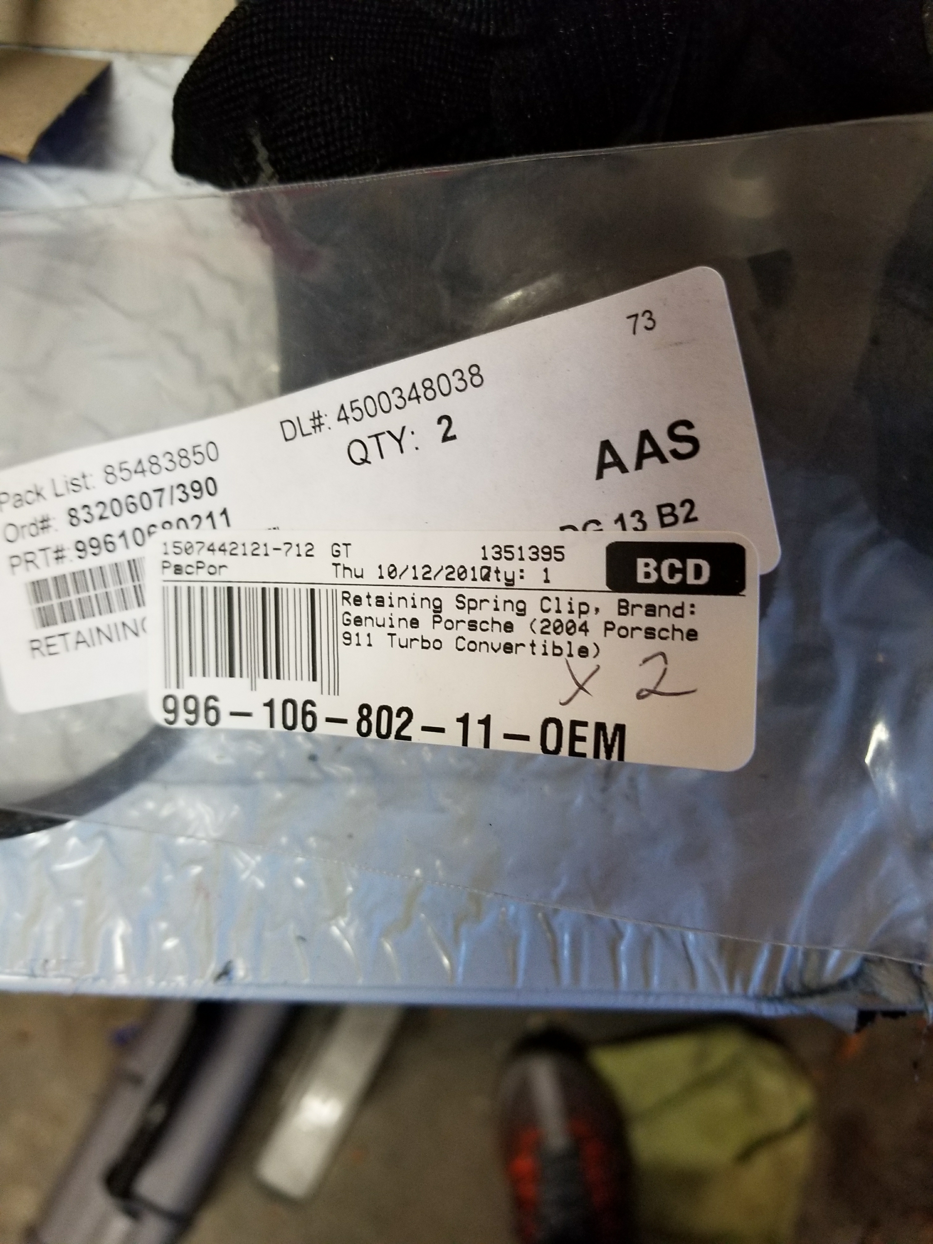

I am using the 11s. They should be working. I expected no problems for Porsche genuine parts... genuine hose, genuine clips...

This is not the official, Porsche tag, I wonder if they did not mix their batch of clips??? Sorry but I am just trying to help ;-)

Old Nov 4, 2017 | 04:33 PM
Stebo's Avatar
Joined: Dec 2015
Posts: 438
From: Jacksonville, FL
Rep Power: 53
Stebo has a reputation beyond reputeStebo has a reputation beyond reputeStebo has a reputation beyond reputeStebo has a reputation beyond reputeStebo has a reputation beyond reputeStebo has a reputation beyond reputeStebo has a reputation beyond reputeStebo has a reputation beyond reputeStebo has a reputation beyond reputeStebo has a reputation beyond reputeStebo has a reputation beyond repute
You know... I wondered about that too. The first hose had red stamping and the second has white. Both came in bags claiming to be genuine from my favorite parts website. I'm starting to have some doubts about authenticity. At this point I don't feel great about the hose or the clips. I know what I paid for, but I'm not so sure about what I received. This whole situation stinks.

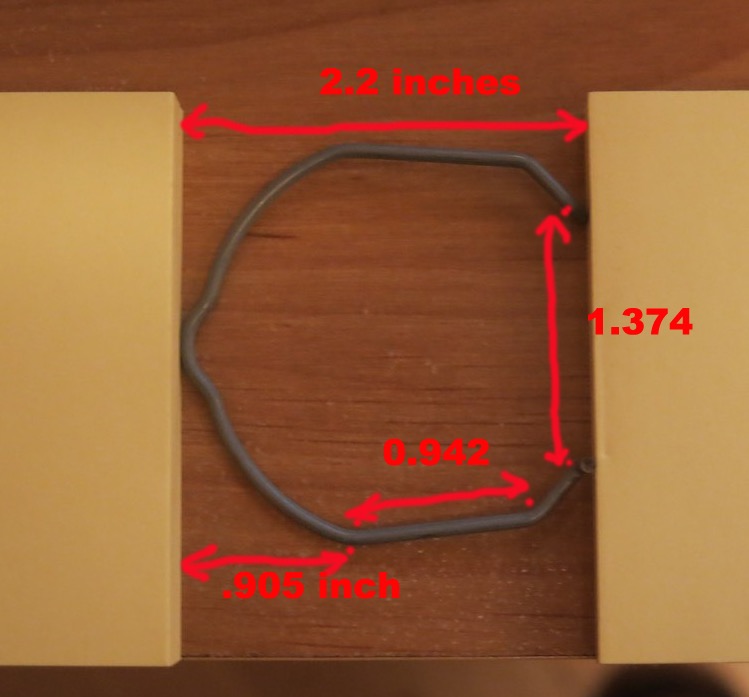

here's some measurement on a brand new unmodified clip part#99610680211. If you need some more specific measurement, let me know......
Old Nov 4, 2017 | 06:01 PM
Stebo's Avatar
Joined: Dec 2015
Posts: 438
Rep Power: 53
JP, you're the friggin man! Thanks buddy
