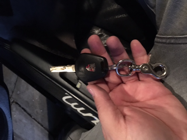

Got 'em! Whew!
I called some Porsche tech friends and found the exact placement of the frunk emergency release wire. Apparently it could be in a few different places. For my 02 turbo is was either under the passenger side headlight which you would need to prop up slightly to get to it, or inside the front bumper cover above the front radiator. I found my wire inside the bumper cover above the radiator...you'll need to pull the grill out and the center air vent duct down to access it.
The dealer service dept was absolutely no help. They told me they rarely work on older cars anymore and don't have any advice except to tow the car in and they will order a set of keys from Germany $500+.

Originally Posted by r6vr6
Guys a key fob is $150 and I just got mine programmed at the dealer for $81 out the door. Drink bud light instead of craft beer for a month and get yourself a new key.
By the way guys, just FYI, the dealer told me they would not be able to program the fob without the car being turned on.
Thanks for all the help, everyone.
