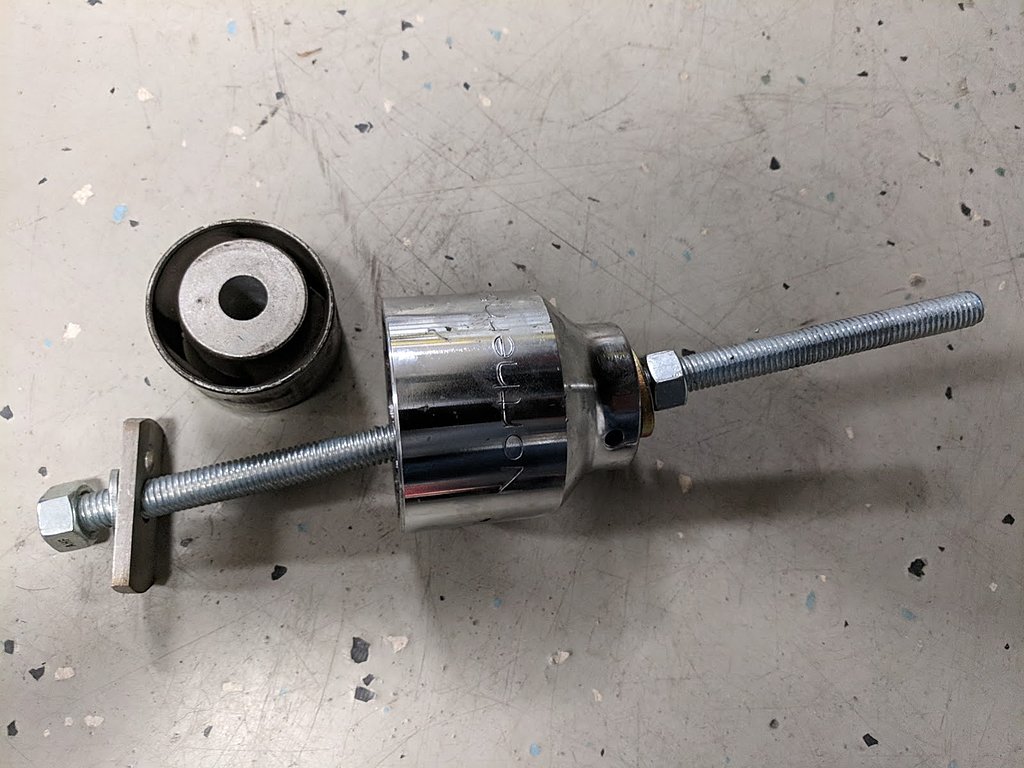

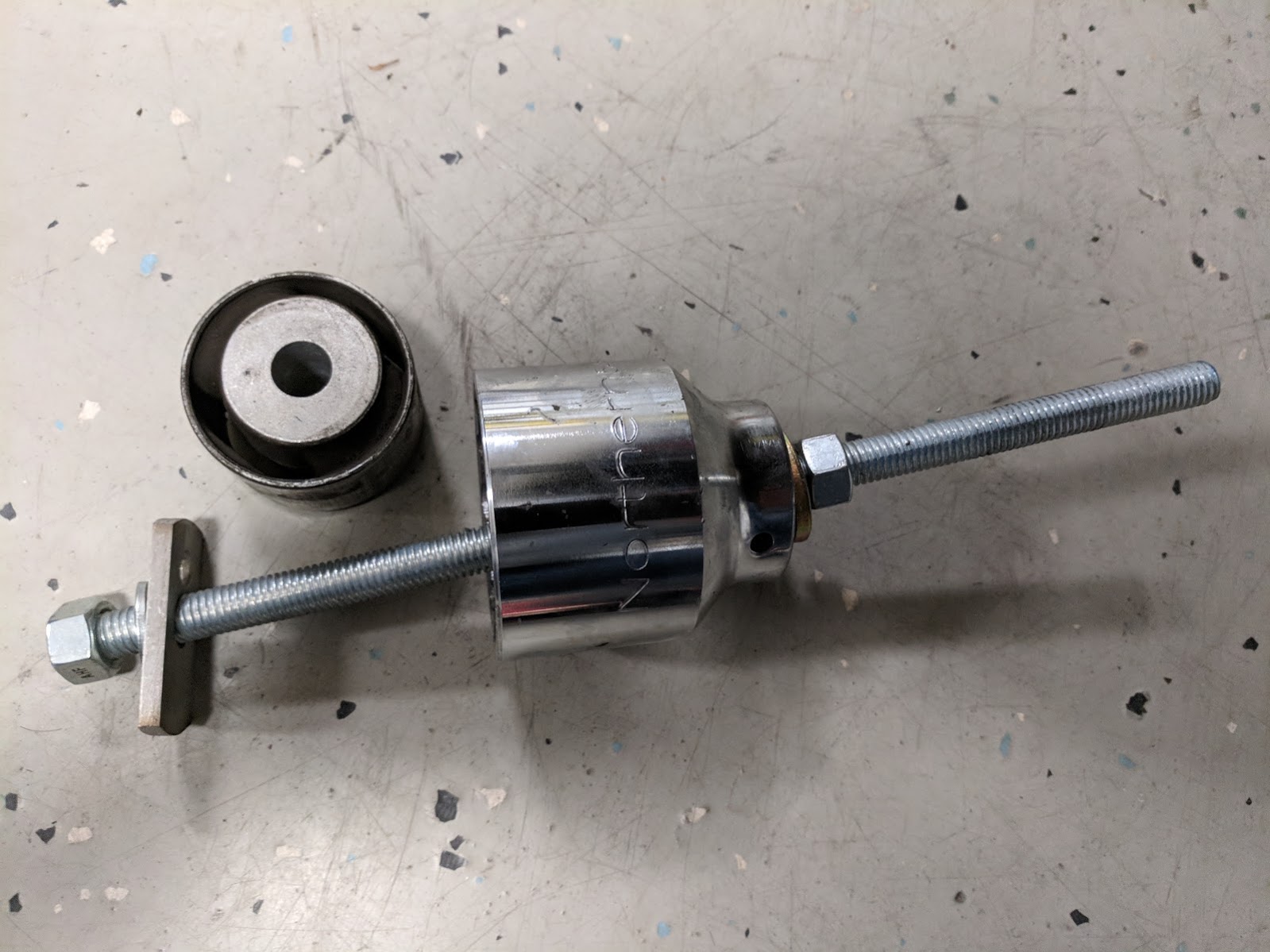

I found this thread after changing my rear lower control arm thrust bushings with solids.
If my car is any indication ('03, 50k miles), your rear thrust bushings are in need of attention too. My main goal was to address tire wear and a hint of bump steer and stability under braking. Worn thrust bushings cause toe changes under load.
I would head pwdrhound's advice as I've found it on point every time.
Here's a pic where you can clearly tell it's permanently off center. Along with the custom puller I kludged together to do it on car.
