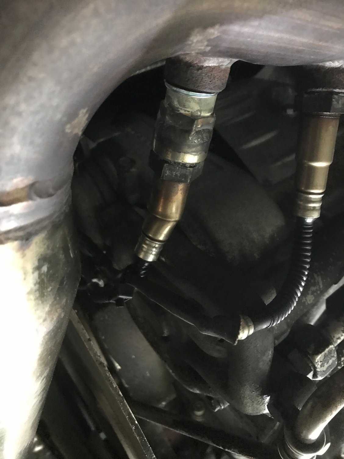

It works, this is what happens Friday drove my car around on the highway and in town. Me I’m going to put my 02 sensor on with a new bung since the exhaust fit like **** and crushed the rear passenger 02 sensor. Jacked the car up, cut the old o2 off since it was crushed against some ****. Put a new bung and o2 on it. Runs like trash with unclearable codes. Pics attached are the old sensor before I cut it.

thats an O2 bung extender on the post cat O2 .Most likely there because no cats and the second O2 isn't turned off in the ecu.
