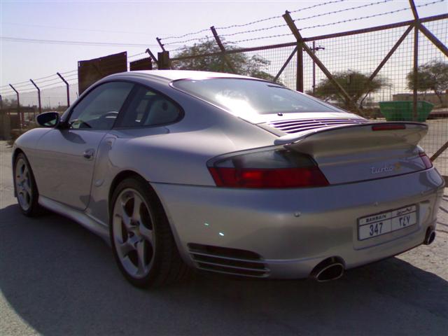

Here's mine again with factory 5mm in the front and 17mm in the back. Been on the car since I've baught it last year and no problems what so ever. I track it like this as well. I thought of putting a 10mm in the front but I'd hate for it to rub so I'm keeping it the way it is for now.
