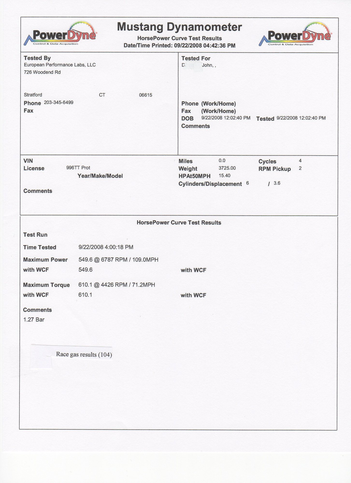

Here is a Mustang Dyno from 2008 of old school K24/18G's (before the billet versions) with full supporting mods on my 996TT. I am not an expert on dynos by any means, so I am not sure if this is a good or bad looking dyno, but have always thought the car was very responsive down low and made good power up top, too. Since you are discussing dynos, I thought some of you may find it interesting, as a turbo comparison data point.
