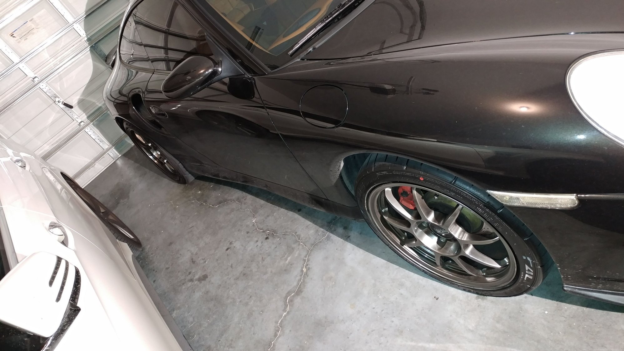

Old Sep 11, 2019 | 06:21 PM
pancing's Avatar
Joined: Aug 2018
Posts: 177
From: florida
pancing has a spectacular aura aboutpancing has a spectacular aura aboutpancing has a spectacular aura about
Originally Posted by Lawman86
I have a simple question that I'm getting conflicting responses to.
My 996 Turbo has the stock hollow-spoke twists with stock tire sizing, but I plan to go to 235/40 & 315/30 when the current tires wear out. Even though the GT2 has 0.5" wider front and 1" wider rear wheels, I've been told using the GT2 sizing is no problem on these wheels.
So with that being said, do I want 7mm front and 15mm rear spacers OR 15mm spacers all-around? I've been told yes for both, which obviously doesn't make sense. I've also had a couple say to go 12mm all-around? My goal is to bring the wheels out to be flush, but my concern is with the wider tires rubbing on the fenders on heavy compression. I'm on stock suspension now as well, but will be putting on Ohlins in the future and lowering the car slightly so I'd like to not buy spacers twice.
TL;DR Stock wheels with 225/40 & 295/30 tires for now, going to 235/40 & 315/30 eventually. 7mm front & 15mm rear spacers OR 15mm spacers all 4 corners?
Thanks!
Hey bud
Gt2 fitment allegrita hlt 235 315 azenis 615k+
Pushes my wheel 15mm front and 10mm out back
What you have to worry about is inner rear fender rub. Im close but i dont rub with stock suspension.
Correct offset is key. If you go with 235 315 you will need 10/15mm spacers to be flush front and rear.
10mm spacers rear if you dont want to roll.
