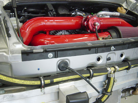

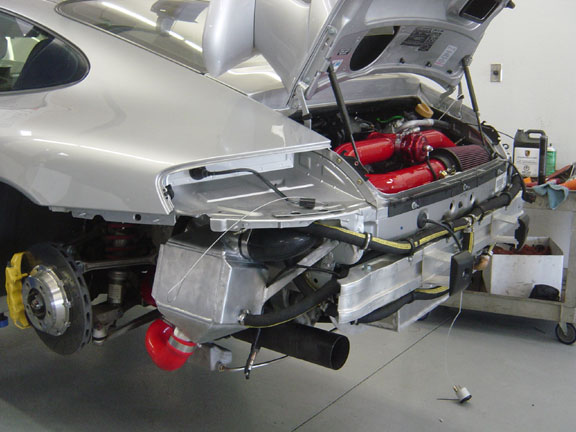

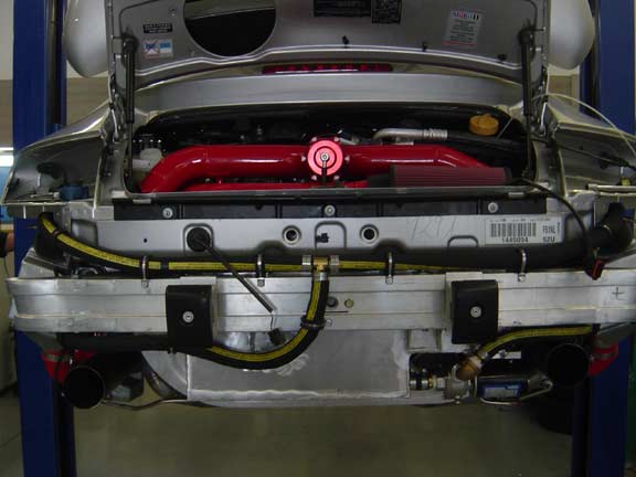

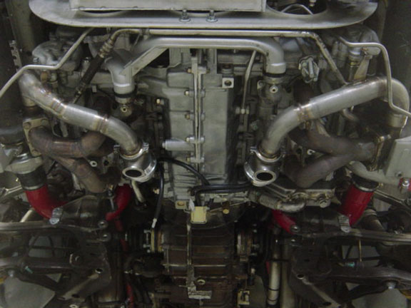

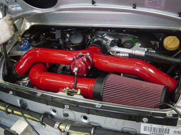

We just finished a GT3 twin turbo conversion. I will post some videos and tuning details later. This one is well over 800 HP. This engine features:
EVO Forged 9.0:1 pistons
EVO / Carrillo Custom Connecting Rods
EVO Head Studs
EVO High Pressure Head Gaskets
EVO Custom 1 7/8 Headers w/ External Tial Wastegates
EVO Modified Garrett GT Turbos w/ Exhaust Housing Wastegate Dumps
EVO Liquid to Air Intercooler System w/ Water Pump, Radiator and Custom 5 Gallon Water Tank
EVO Custom Fabricated Turbo Air Feed Pipes
EVO Custom Fabricated Turbo Y-Pipe w/ Tial Blow Off Valve
EVO Fuel System w/ Custom Fuel Lines, Pump, Filter, Fuel Rails, Injectors, FPR
EVO Modified GT3 Manifold
Stock GT3 Heads
EVO/GIAC Calibrated GT3 ECU

This car started life as an 04 GT3 narrow body car. There are no "off the shelf" parts on this engine conversion. I will post some photos of the completed car in a few days. From the outside, it looks like a totally stock GT3. Talk about the ultimate sleeper.
