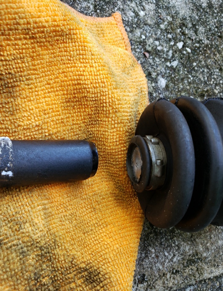

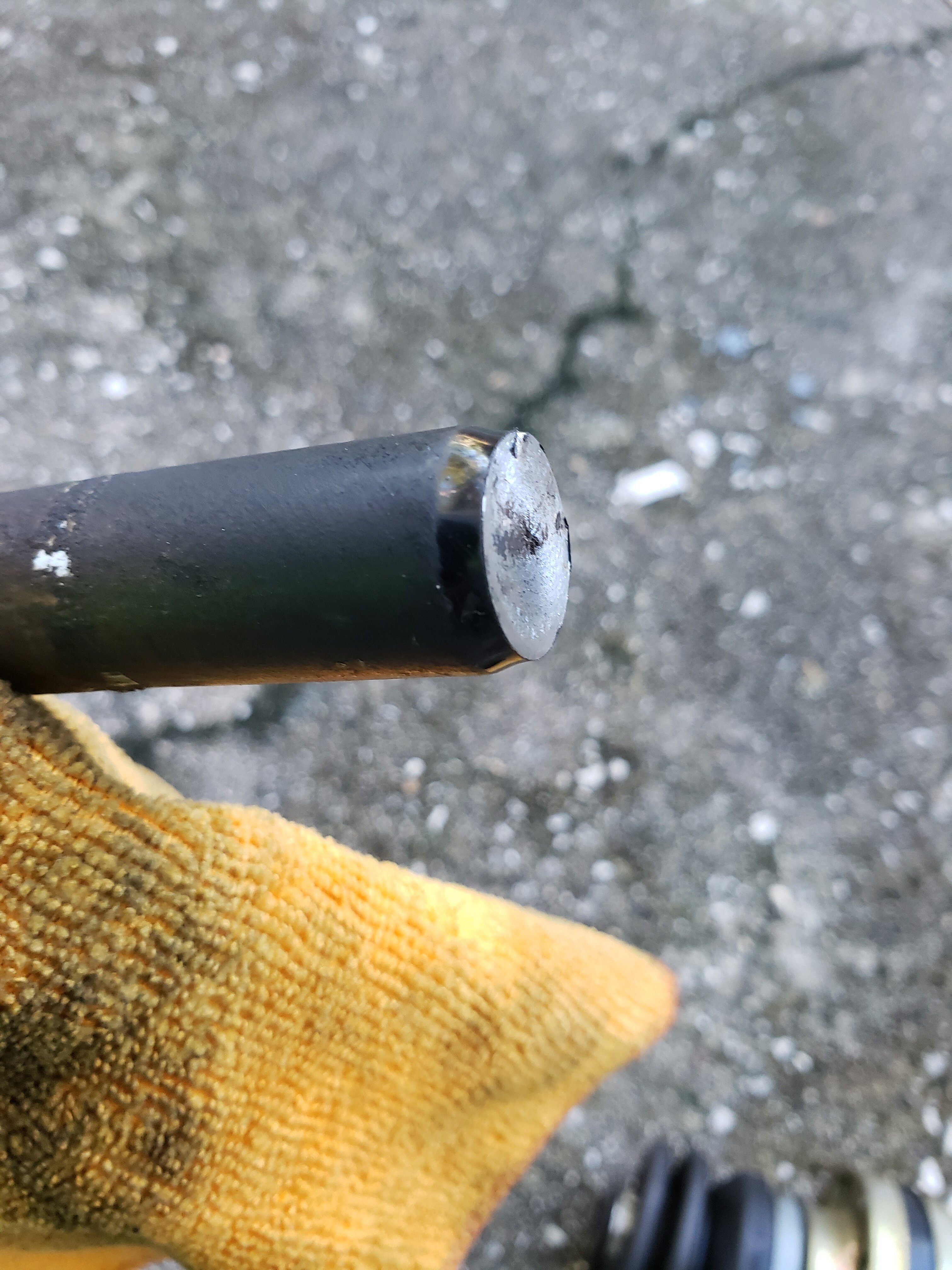

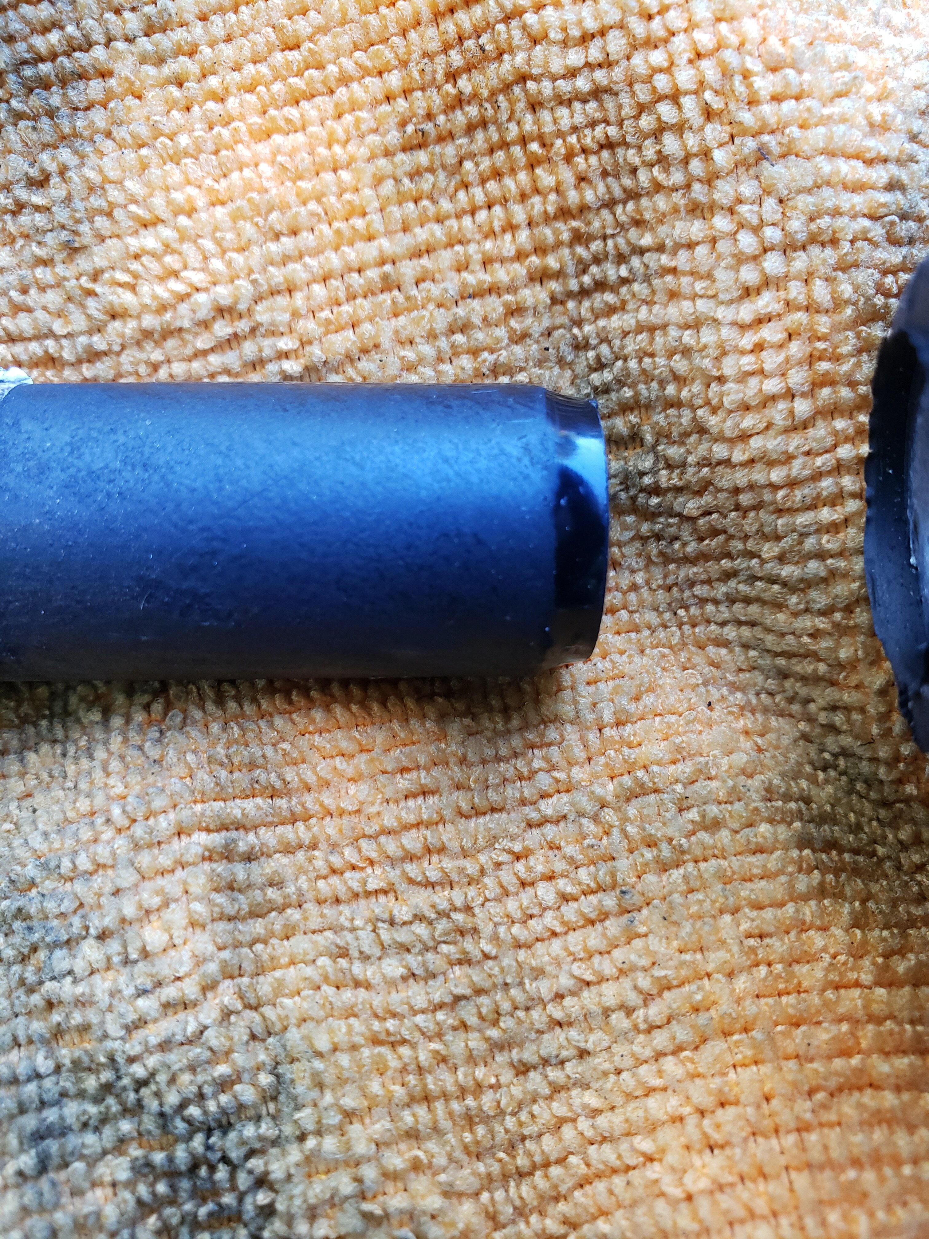

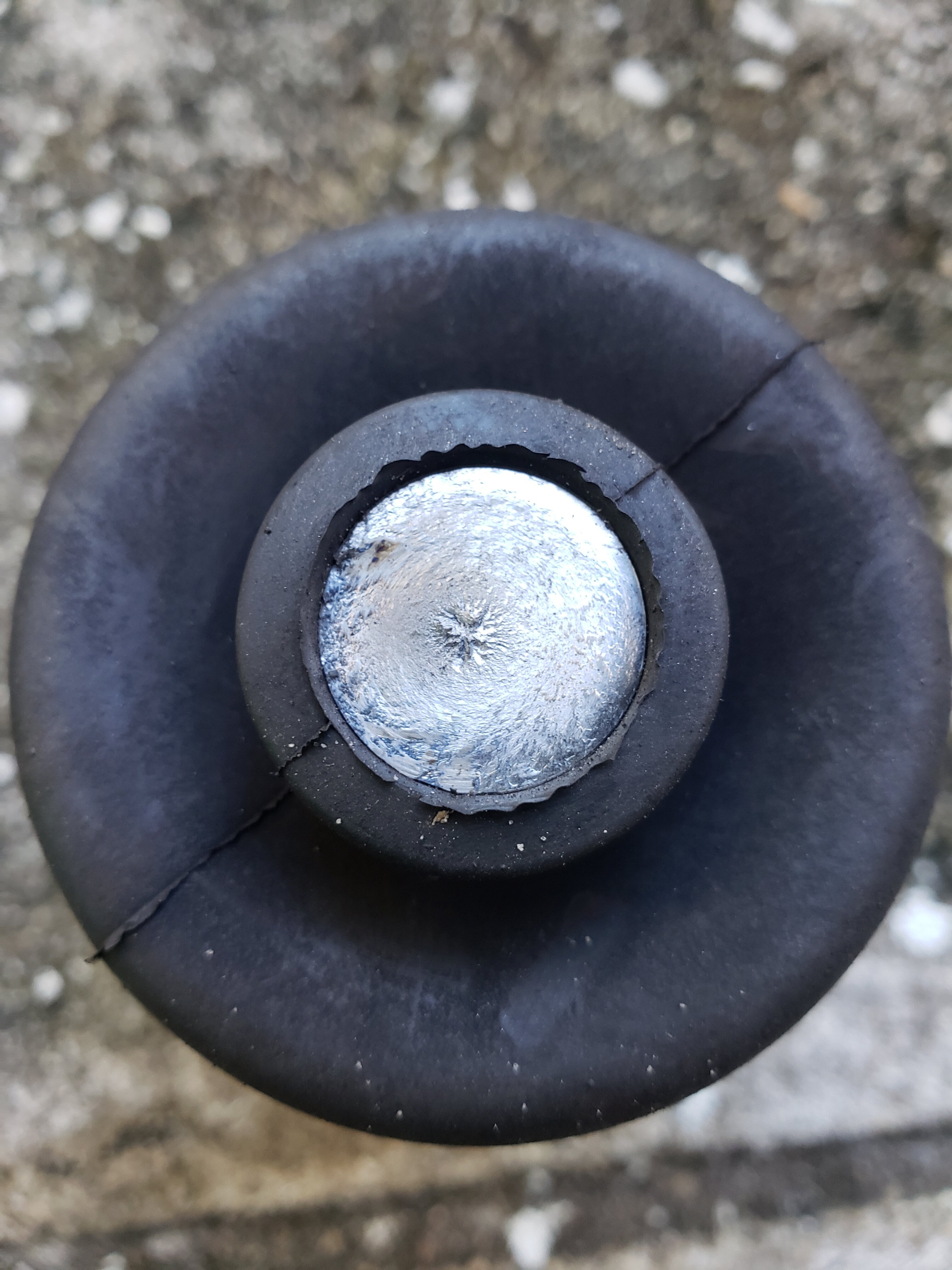

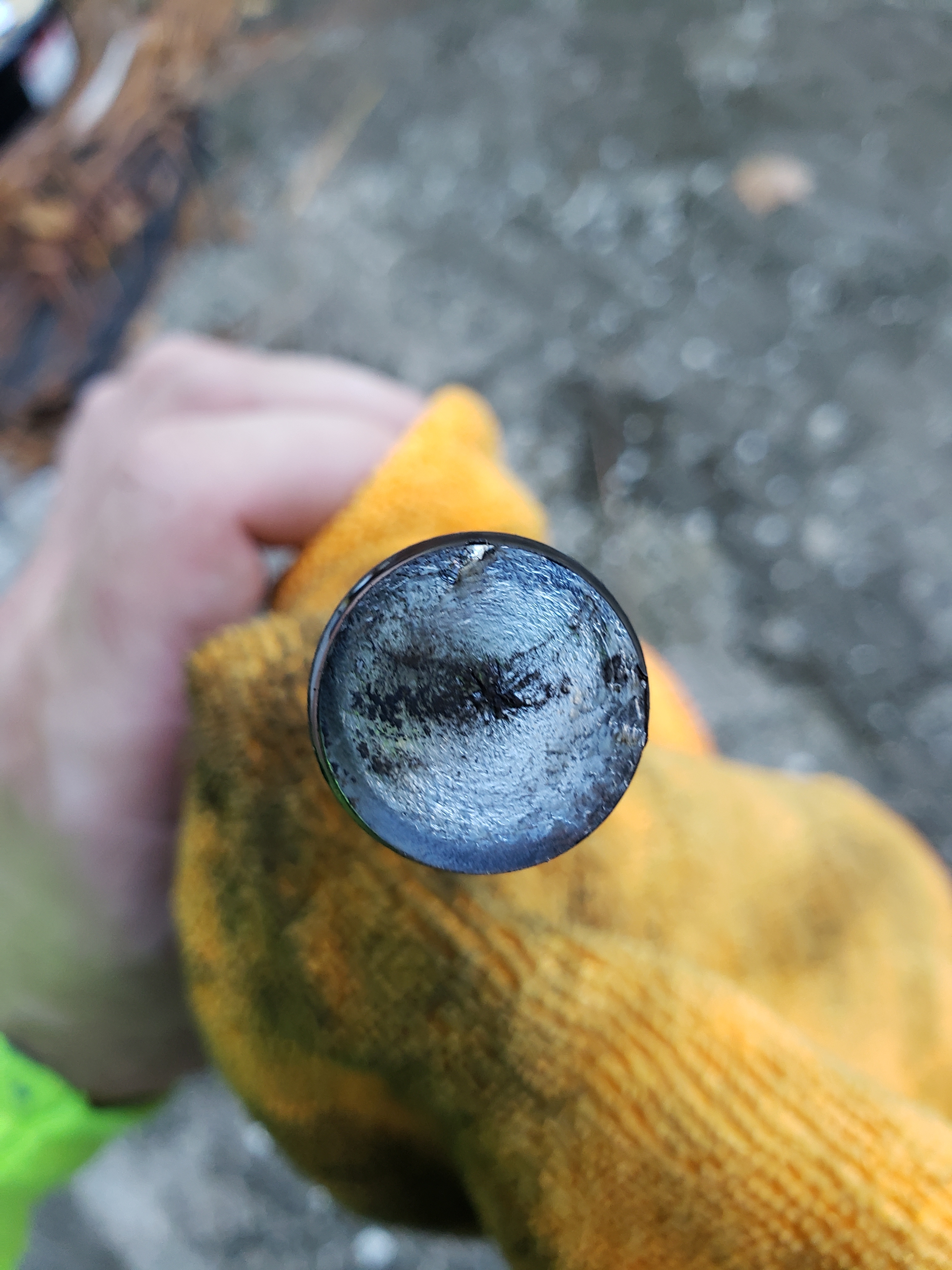

Here's the damage. It broke clean right at the neck-down portion of the shaft for the clamp of the inner cv boot. Luckily it didn't even scratch anything else when it let go. No collateral damage!
