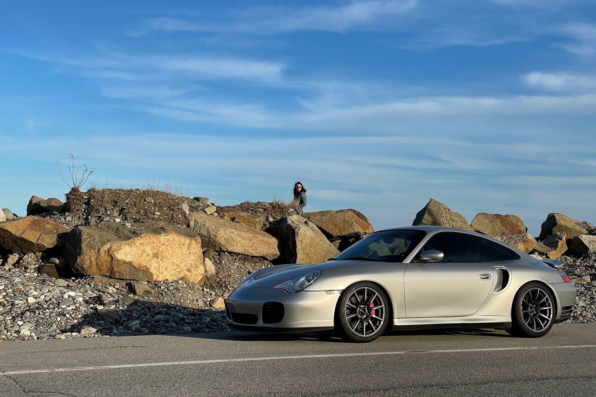

Hey Apex, figured I'd add to your inspiration above haha

I went with the gt2 fitment
18x8.5 fronts (235 fronts)
18x12 rears (315 rears)
Best set up with the proper alignment, coilovers, sways etc. The Apex wheels were the perfect addition and I recommend them to all.
