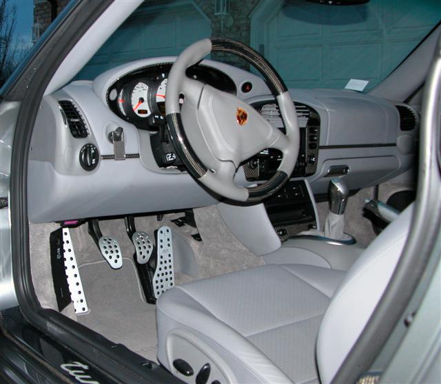

it's not hard. Just get a good bit for metal, and a corded drill.
here's a pic of my techart pedals from a few years ago...

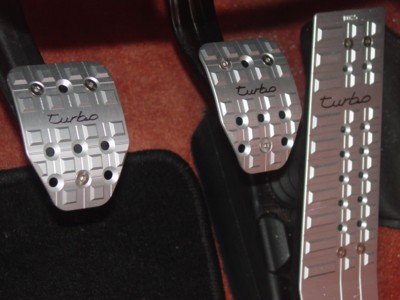

Mine are pictured below. This was a PIA due to tight quarters and not buying a TITANIUM bit right away for the brake pedal (the other two are easier). The corded drill motor works better because its smaller.
The biggest problem is lining up the pedals and marking the holes. I used a C clamp and paint stick. Take your time, because I see so many installed crooked it drives me crazy.
I bought the pedals that say Turbo.....why buy anything else

Hey Shark01, thanks for the pic. I looked at some similiar ones to yours, but was more concerned about my shoes slipping on them (no rubber stubs). I tend to wear leather bottom dress shoes to work, and was worried if they were wet, they would slip off the pedal. I do like the Turbo insignia on them though.

Shark, do you have a matching dead pedal?? and where did ya get em?? They look great!!

M3CAB,
the techart pedals are textured kind of like diamond plating, so I've never had any slipping problems. There's quite a lot of grip.
