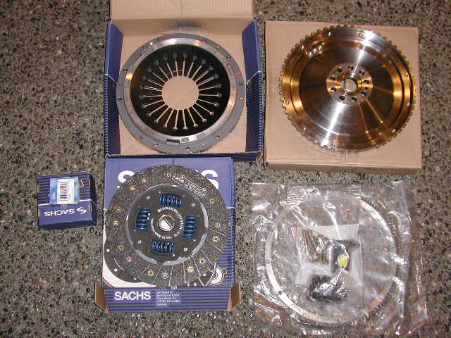

Ok I guess I will re disagree. I have the sachs clutch and LWFW. To anyone who drives a stick this exact set up is as close to normal to drive on the street as you can get. It is in no way like the all off or on of a race clutch. So driveablity on the street is NOT an issue. So look at the pros and cons. Pros you have a car with quicker acceleration and easier heel toe at the track with NORMAL street manners. The only con I can mention is that it is somewhat noisey. of course that mechanical car noise went into the pro category for me as well. So as others have said it just depends on what you are looking for. I just didnt want anyone to make a poor choice because they were afraid the car would not drive "normally" it does.
There are many threads about this topic on rennlist and many have gone to the same setup with virtually no complaints. I have personally talked to 5 before they changed and after all were happy.

OK...my thoughts. I have the sachs stage 2 with LWFW. I agree 100% with Tom (which does not mean we speak for all of course). The clutch is easy to use for street (virtually no difficulty at all for me)...there is a slight sound when the clutch is let out sitting at the light, but really not disturbing. The performance I feel is much better in terms of responsiveness. This, like the SSK, is how this car should come IMHO.

I had the sachs RS(964 and 993) clutch with the light weight flywheel(964 RS) that FVD sells... its a 1127 Nm clamping force... and It was just liek stock... I loved it... When we took it out it had nominal discoloring.. and thats after 50 1/4 mile runs... all I know is that it was a genuine sachs set up... and it didnt skip a beat.
Im sure Stephen knows exactly which one it is...

I must have been lucky cause my first after market clutch( and only one so far)... seems to be the smoothest thing out there... ( granted it has a little chatter.. but you get used to it.)
One has to realize that as with any performance racing part... you loose some degree of drivability.... and yet I believe sachs( at least the kit I have) is very close to stock drivability with the performance of a racing clutch.
