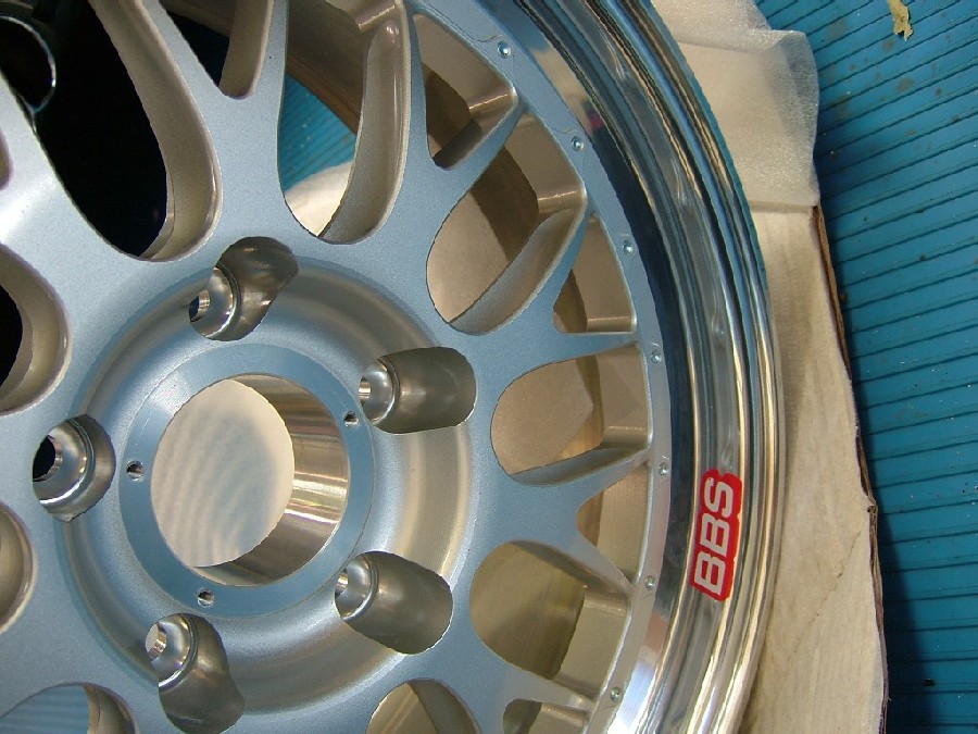

Thanks! I'm getting some of the new BBS Aluminum Racing Wheels. 8 1/2 & 12 x 18. I'm giddy as a school girl! It's going to take a few weeks for delivery, I can't wait!
