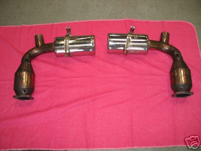

Has Anyone Seen a Custom Exhaust Like This Before?
Just curious.

just cats...

And mufflers but since they are after the exit to the tips I'm assuming this thing would be loud. That's a good thing though.

Looks like the B&Bs.. will be loud as hell!

sharkster: I would run your setup if I wouldn't get a CEL. I don't know if this looks like a B&B exhaust. There is one pipe going into the muffler but nothing coming out of it like a B&B or most exhaust to the exhuast. I don't see the point of the muffler in this pic since it's past the pipe for the tips.

It's B&B. I had a B&B on my Z06. The canister is designed to be an air spring and resonate at a half phase out with the exhaust at certain frequencies to remove certain tones. So... it muffles out a tone, but not the loudness and it does a good job of it.

The muffler/can is like an "optional" one I think... where some of the air flows that way. Strange but it seems to work ok.

That's going to sound like a harley...

That's the B&B setup. I had it before I traded with Sharkey. He and I will both tell you one thing: it is loud. The real problem is the resonance, though. It will make you want to "pop" your ears by opening your mouth real wide (like when you are at altitude in a plane). That happens around 2000-2200rpm with the B&B GT pipes.

I decided to pass on this. I am thinking of a GHL exhaust, Fabspeed Super Sport or just the Fabspeed 100 cell Cats with muffler bypass pipes.
