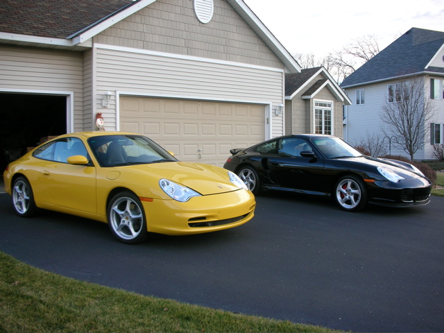

Pictures finally!

Nice car...looks a lot like mine I see 0.9 bar max boost; but not in all gears. Sometimes it only hits 0.7-0.8 at WOT in gears 3 and 4; other times it hits 0.9. I've even seen 1.0 bar flash when its really cold out.

Welcome...nice buy!
