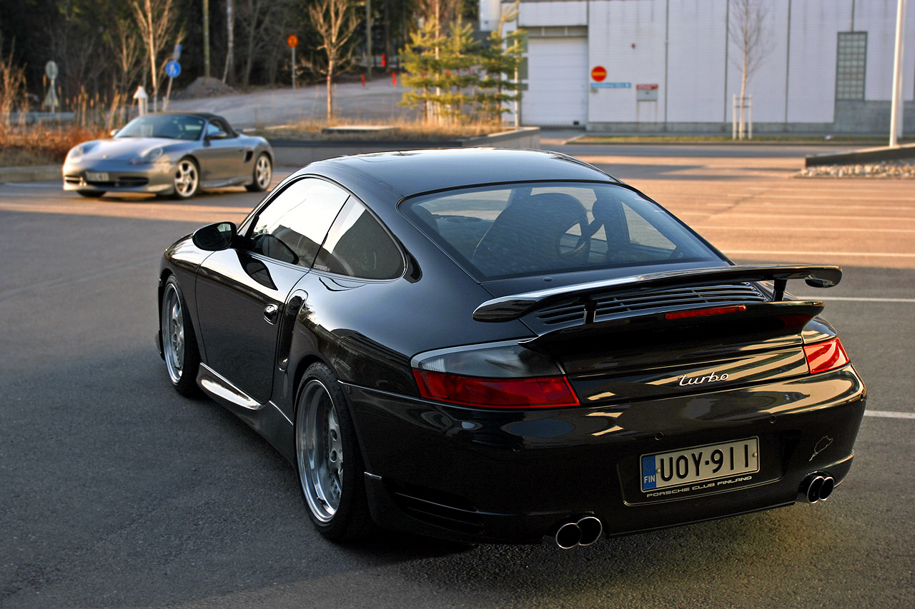

11x18" ET25 with 295/30/18 PS2/Corsa/MPSC and FVD PSS9 on eurospec car (low) = No rubbing and looks so nice
With 18" you have less problems and easier to pick proper tires....
