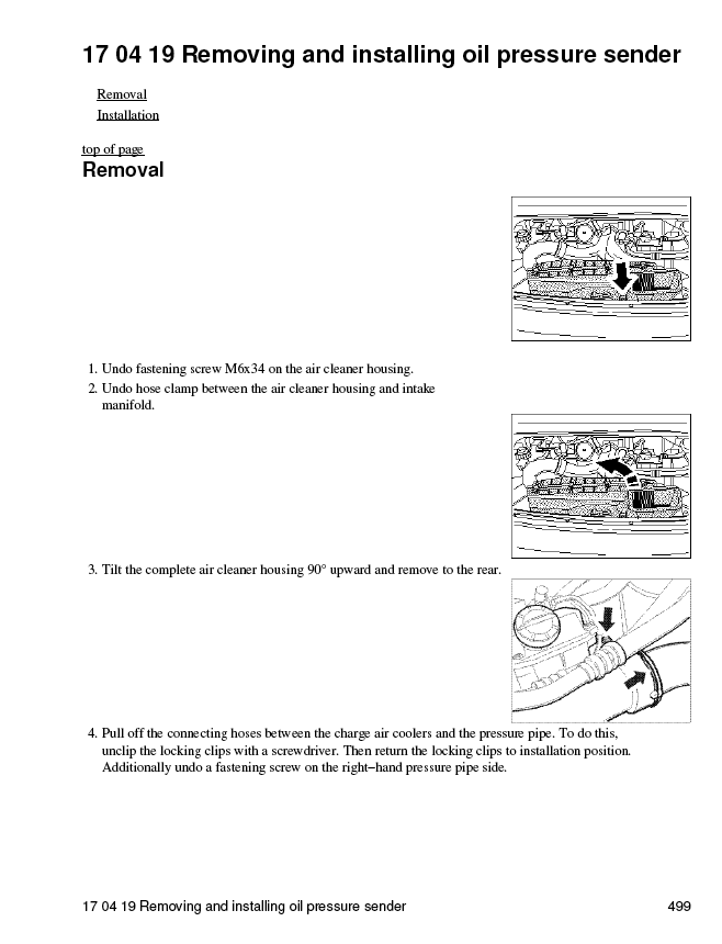

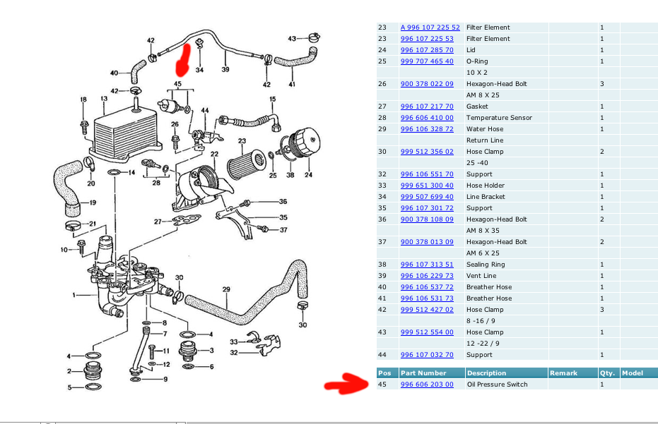

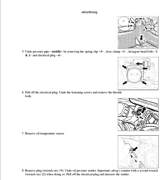

Oil pressure sensor (Porsche call it a pressure sender) are known to fail and it is the cheapest thing to replace for troubleshooting purposes. Part# 99660620302 about $65.00 and not a bad job to replace but tight spot....

Common problem. a search here revealed that the wire connection at the oil pressure sending unit is most likely the cause of the intermittent oil pressure gauge fault. If that doesn't fix the fault replace the sensor.
I can't believe that the dealer would replace the cluster without checking the sender and the sender connection.
