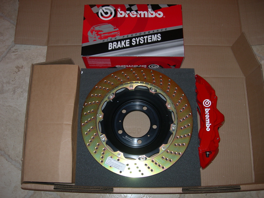

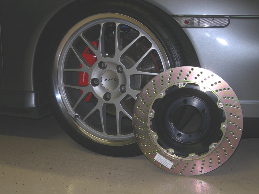

Originally Posted by jstrat85
this is your only solution! thats what i did!

i think like 3gs

Where did you order from, and is that just the 6 piston front kit?

brembo does not make the 8 pot any more. now they make the six pot wich are lighter thank the 8 pot and are better than the 8 pot. call sanders at the wheel supply and talk to him. his number is 19094681311 and tell him you saw them on johns car from new york.

im waiting for my wheels to come in so i can install my bbk, i also have the car at the body shop installing a gt2 front bumper. if you need more pics let me know.
