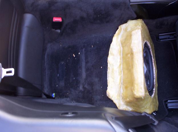

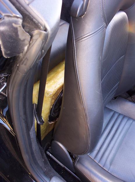

man am i sore! i made a custom sub box and ran 2 sets of wires to all speaker location for planning of components
pictures if the sub box is below, still have to cover it with carpet, it sounds really good, still debating if i will put one on the drivers side

well i was impressed i made a fiberglass speaker box on my own......humph!
