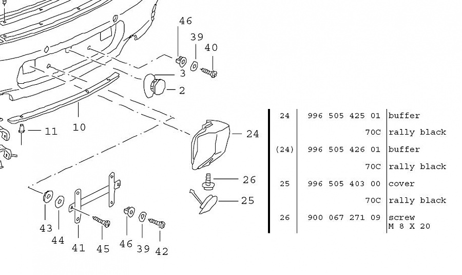

I wanted to get my bumperettes painted, but I'm not sure how to remove them. I have a 2000 C2 Cab and I have tried various methods of removing these pieces, but I don't want to damage them.

If the 2000 bumperettes are the same as the 99, (not the 02+ painted ones), then it only takes about 10 minutes. You need a long allen wrench, #6. Be careful not to scratch the bumper while turning. When the bolt releases, the bumperette will slide off easily. Be very careful.

yeah i have an 01 and AFAIK there are 2 screws allen or whatever it is UNDERNEATH the bumperette. The hole is very deep hence you need the long wrench to reach.
It should literally take you 10 mins. good luck!

very simple to remove,just use an allen wrench.i changed mine in 15 minutes....i have the guys name who did mine n came out very nice.pm me if you like.he is out of florida-

Thanks everyone! Yeah, I saw the bolts underneath the bumperettes, but I wasn't sure what size allen to use. I'll give this a try over the weekend.

Originally Posted by flaxpond
Is it the same for a 2002 cab?
Similar, but the bumerettes are painted and have a cap covering the screw.

I checked today mine do not have any caps to remove them?

I took off mine today and repainted since it looks sort of faded.. anyhow it was super easy to take them off.. mine doesn't have any caps for the screws...now it looks brand new ... thanks for the tips and info folks...
